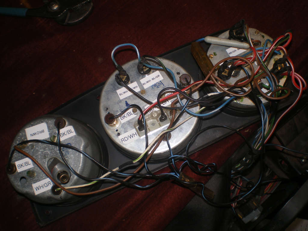

So it's time for an update as it's been a couple of weeks. I'm not able to report the progress I had hoped but here I am.
Flushed the block. Surprisingly small amount of rust in the block
Finally removed the last of the silicone from the frame with a wire goto brush. Lost a little paint here and there so I primed and painted that area with some black which I had on hand. No biggie as it will be hidden from view. Just teasing you in that one pic Bob. (IMG:style_emoticons/default/happy11.gif)

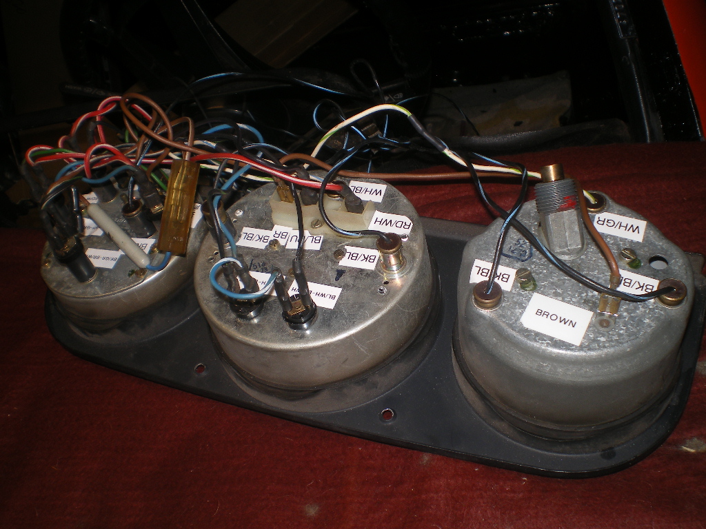

I believe I'm at about 90% complete with the wiring. I've powered up both circuits going into the cabin. I have all of the gage lights working, as well as headlights, parking and turn signals, fan lights, pop up headlights and horns. Jesus H Christ Bob. What horns are those? I can't hear myself fart anymore and those horns scared the Hell out me. :rotfl : I should receive the fan controller and Dakota Digital Quad gauge by Monday and hope to be complete with wiring in the next week.

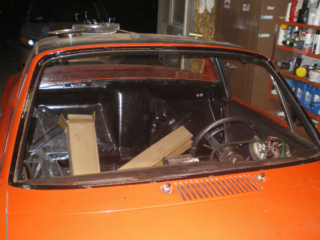

76-914   Finally got a chance to work on Red today. Finishe...   Oct 28 2017, 09:40 PM

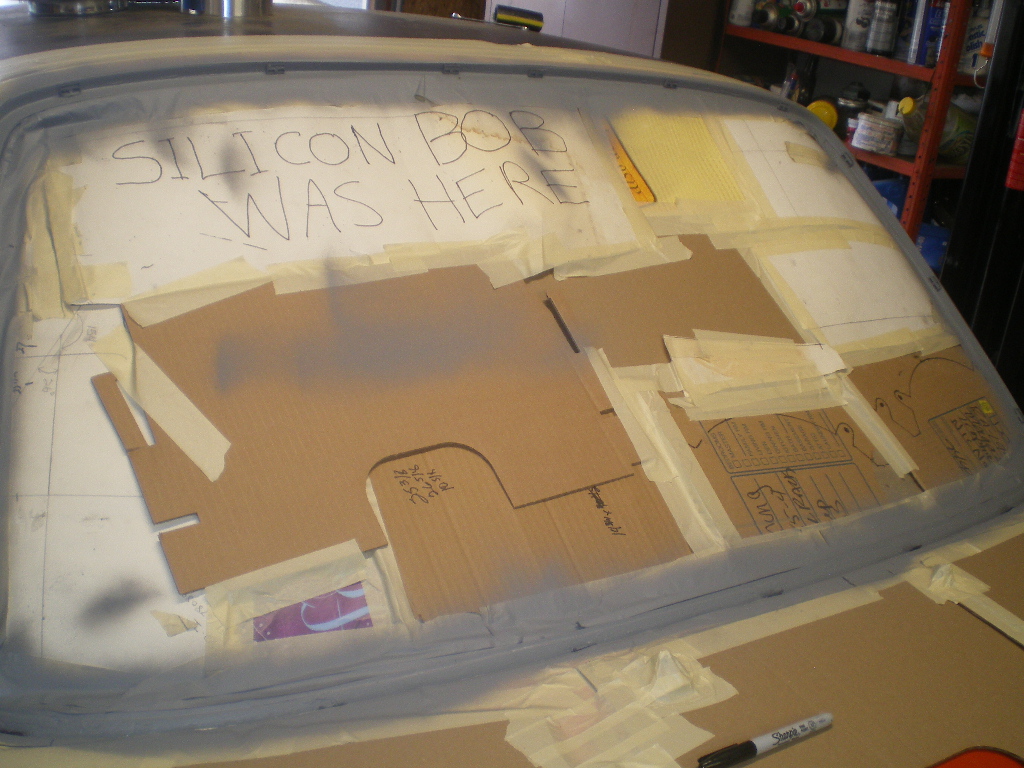

76-914   Made the rough cut templates out of cardboard. The...   Nov 2 2017, 08:23 PM
76-914   The side will get a trim flange to fill the void o...   Nov 2 2017, 08:27 PM

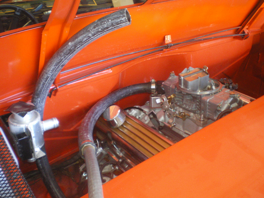

76-914   Since I have this huge mass of cast iron I added a...   Nov 25 2017, 06:41 PM

914350   I love the way you mounted the radiator. The shrou...   Dec 13 2017, 11:18 AM
76-914   I love the way you mounted the radiator. The shro...   Dec 13 2017, 06:31 PM

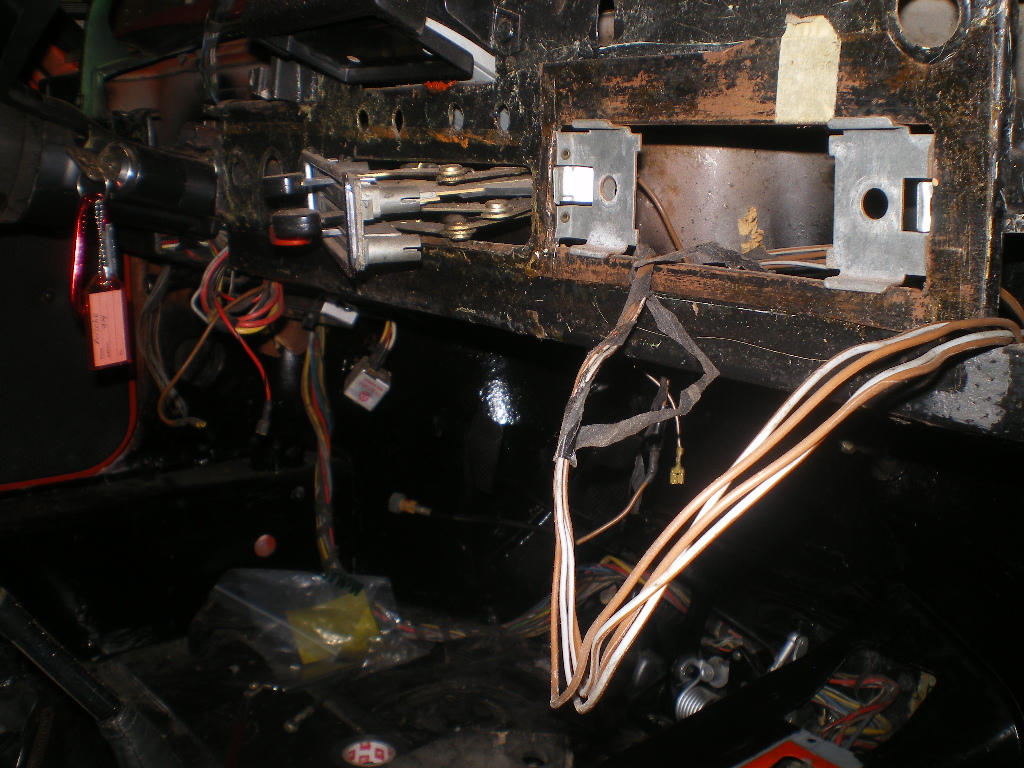

76-914   So I'm killing time waiting on the mufflers to...   Dec 14 2017, 07:16 PM
76-914   I've decided to complete this 914 w/o a radio....   Dec 16 2017, 07:40 PM

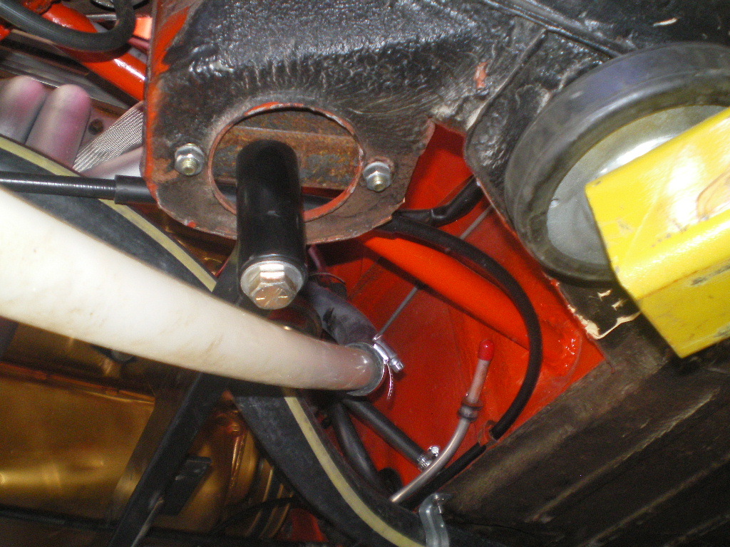

76-914   I forgot to add these pic's once I closed up t...   Jan 14 2018, 01:39 PM
mepstein   Very clean looking. Is that an RH setup?   Jan 14 2018, 01:49 PM
Mueller   Nice radiator setup...might want to add a bead or ...   Jan 14 2018, 02:31 PM

76-914   Very clean looking. Is that an RH setup? Don...   Jan 15 2018, 09:19 AM
