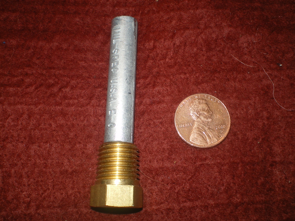

Since I have this huge mass of cast iron I added an anode rod to protect my aluminum radiator. Cheap insurance.

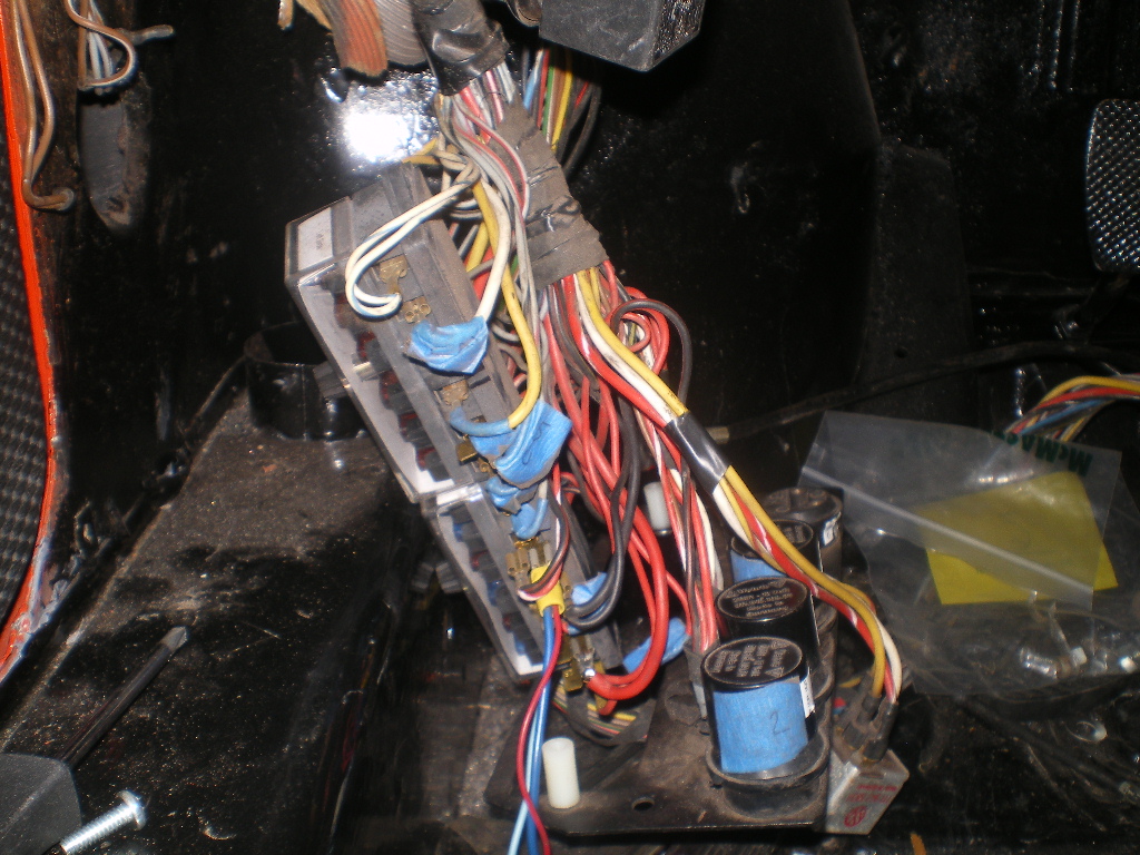

Of all things the blinkers quit working so I submersed myself again only to find it was the ignition switch. BTW, Pelican does not stock them and only orders one once they've received your payment. Big of them, Huh. May Mark will stock them as we all know the Chinese switches are crapola.

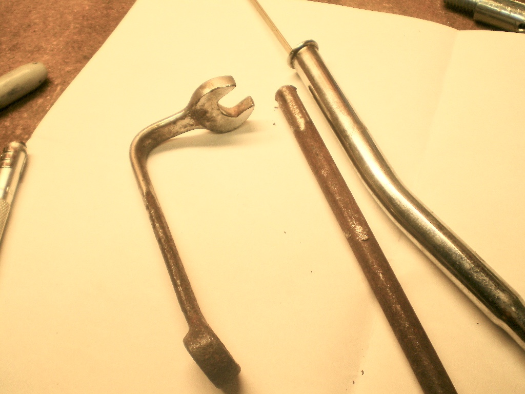

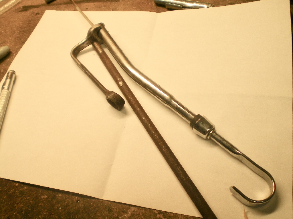

Then I happened upon the 4th Circle of Hell. The dip stick tube was broken and needed to be replaced. This is the old one. I thought the broken piece was difficult to remove but it paled in comparison to installing the new one.
There was no Good place to tap the new one into place. I thought about using a long large screwdriver but that would have place too much force upon the flared section of the tube. I farted around for 2 hours before deciding upon this method. I heated a cheap 7/16" wrench. It spread the load across the flared section enough that I could hammer it into place with a 1/4" steel rod. Hard to visualize but it worked. Three damned hours to R&R that thing.
