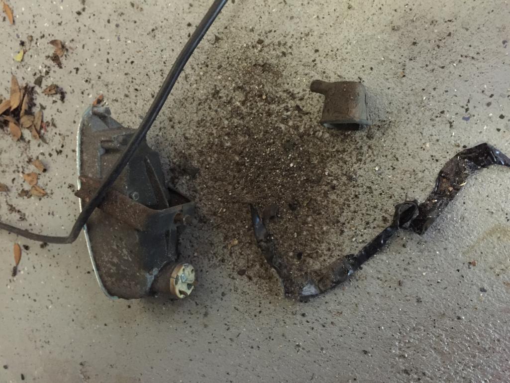

lots of sand in the rubber seal thst is supposed to cober the back side of electrial connectors for turn bucket - also some rust in the ftont trunk seal channel,

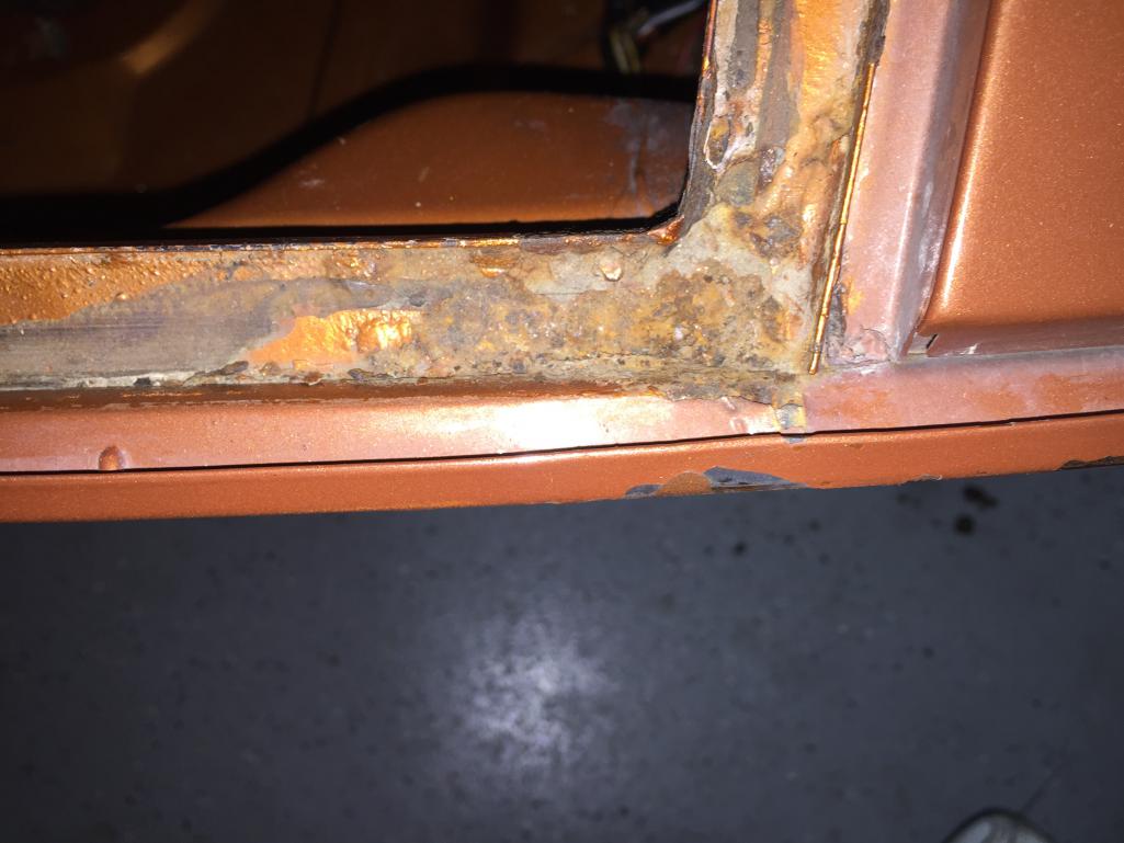

Philip W.   one small sopt of rust thru on the targa area on ...   Nov 5 2017, 05:37 PM
