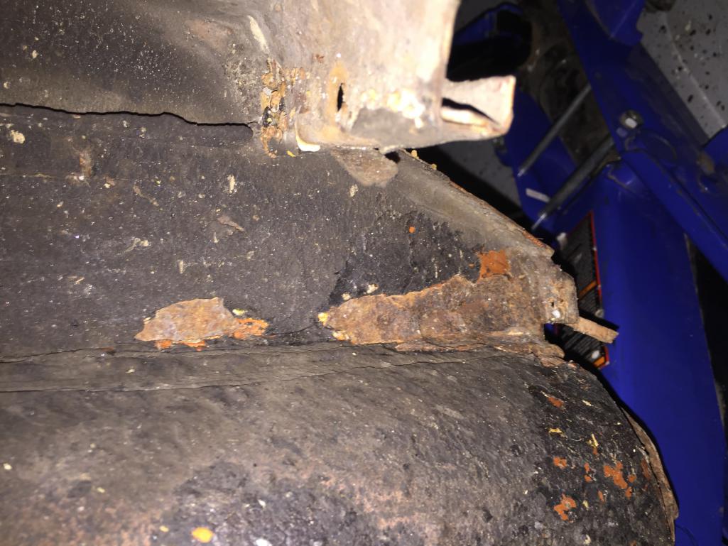

mess and a bit of rust in the fender wells behind front bumper
