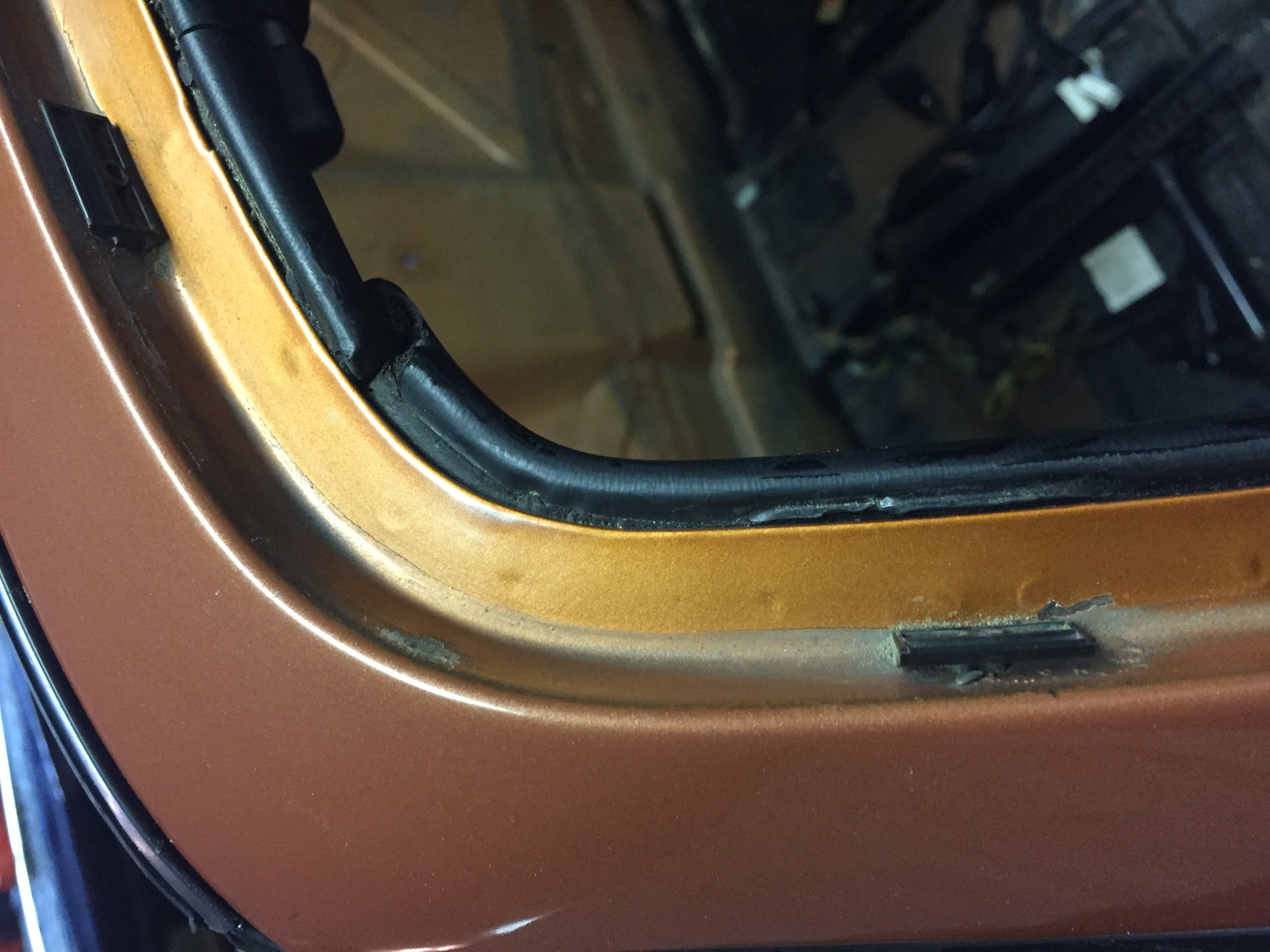

DRPHIL914
post Nov 27 2017, 11:07 AM
Dr. Phil
Posts: 5,971
Joined: 9-December 09
From: Kennesaw, GA
Member No.: 11,106
original copper undwr the window trim show the difference from the respray thats coming off

Philip W.   original copper undwr the window trim show the dif...   Nov 27 2017, 11:07 AM
