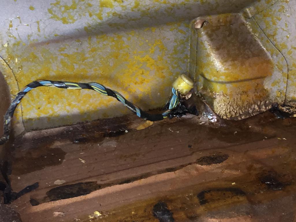

Philip W.   front foot well with the foam out, this will all g...   Nov 27 2017, 11:08 AM
Philip W.   can you name that wire??   Nov 27 2017, 11:09 AM
mepstein   can you name that wire?? Erg wire   Nov 27 2017, 01:44 PM
Philip W.   can you name that wire?? Erg wire Winner...   Nov 27 2017, 02:10 PM
