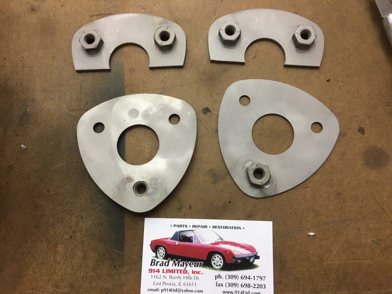

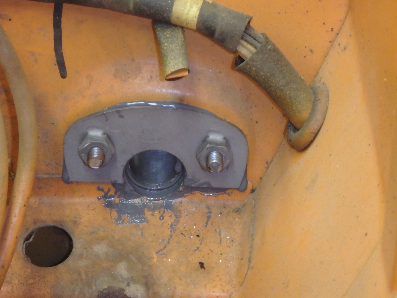

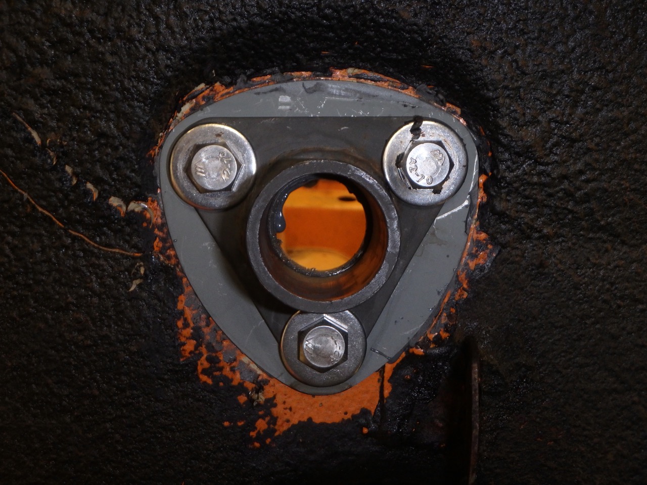

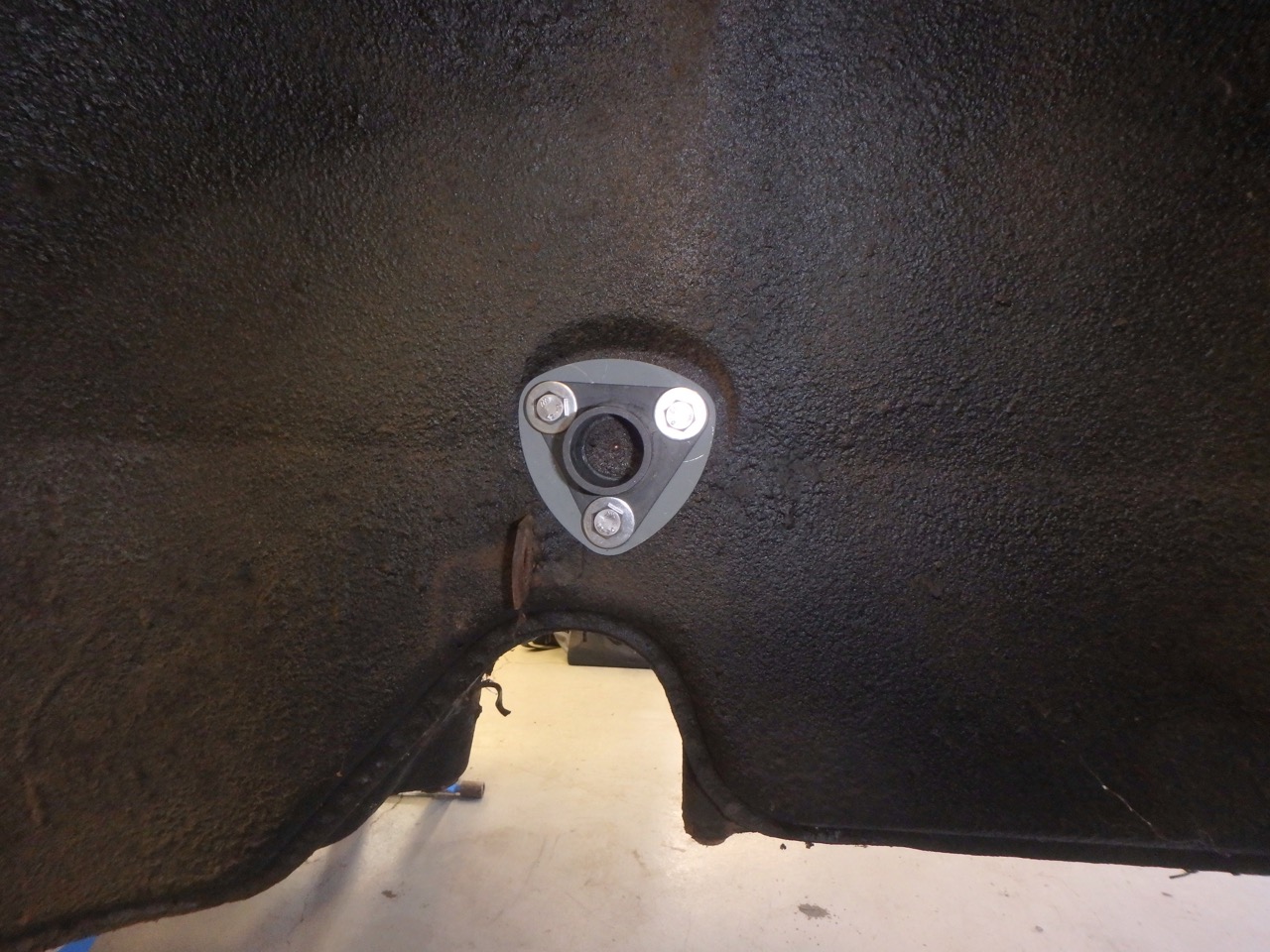

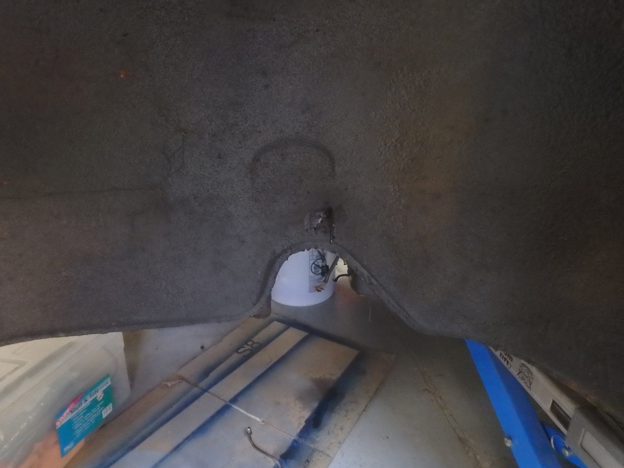

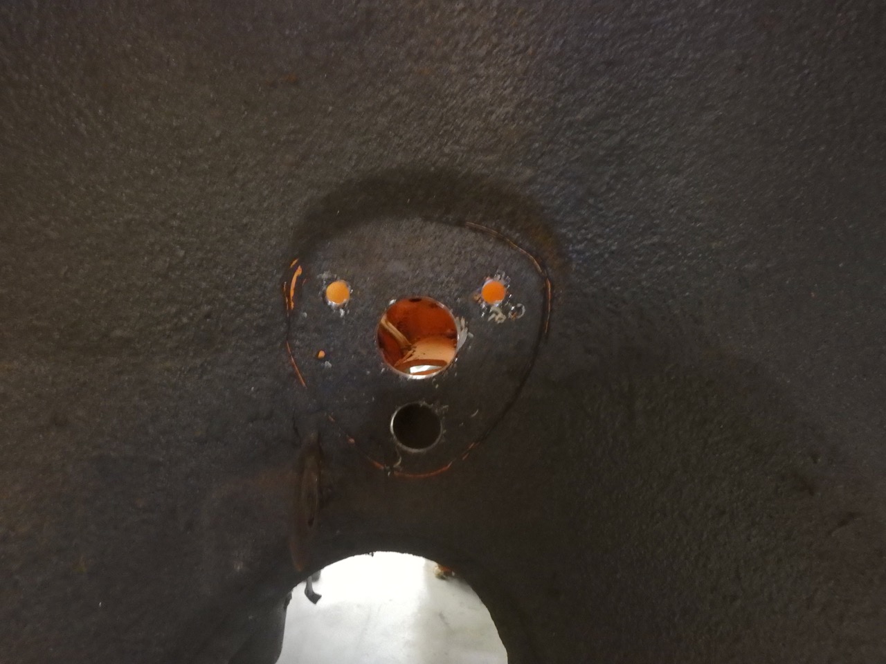

First up Passenger side sway bar mount. At least Prep.
For refresher I am using Brad's mount on the 914-6 (IMG:style_emoticons/default/aktion035.gif)
So I signed up the backside with the notch in the wheel well and used a transfer punch to set my first screw location. Drilled it, opened it ou for the bolt, and bolted it together. Moved the transfer punch to the next hole, and got a center mark, and drilled it out. I then bolted the sway bar mount in place to give me the location of the lower hole. I marked the center, and then drilled a pilot and then used a step drill to punch it out to clear the not on he back side of the Brad's outer plate.
That all done it looks like this.
Attached Image'

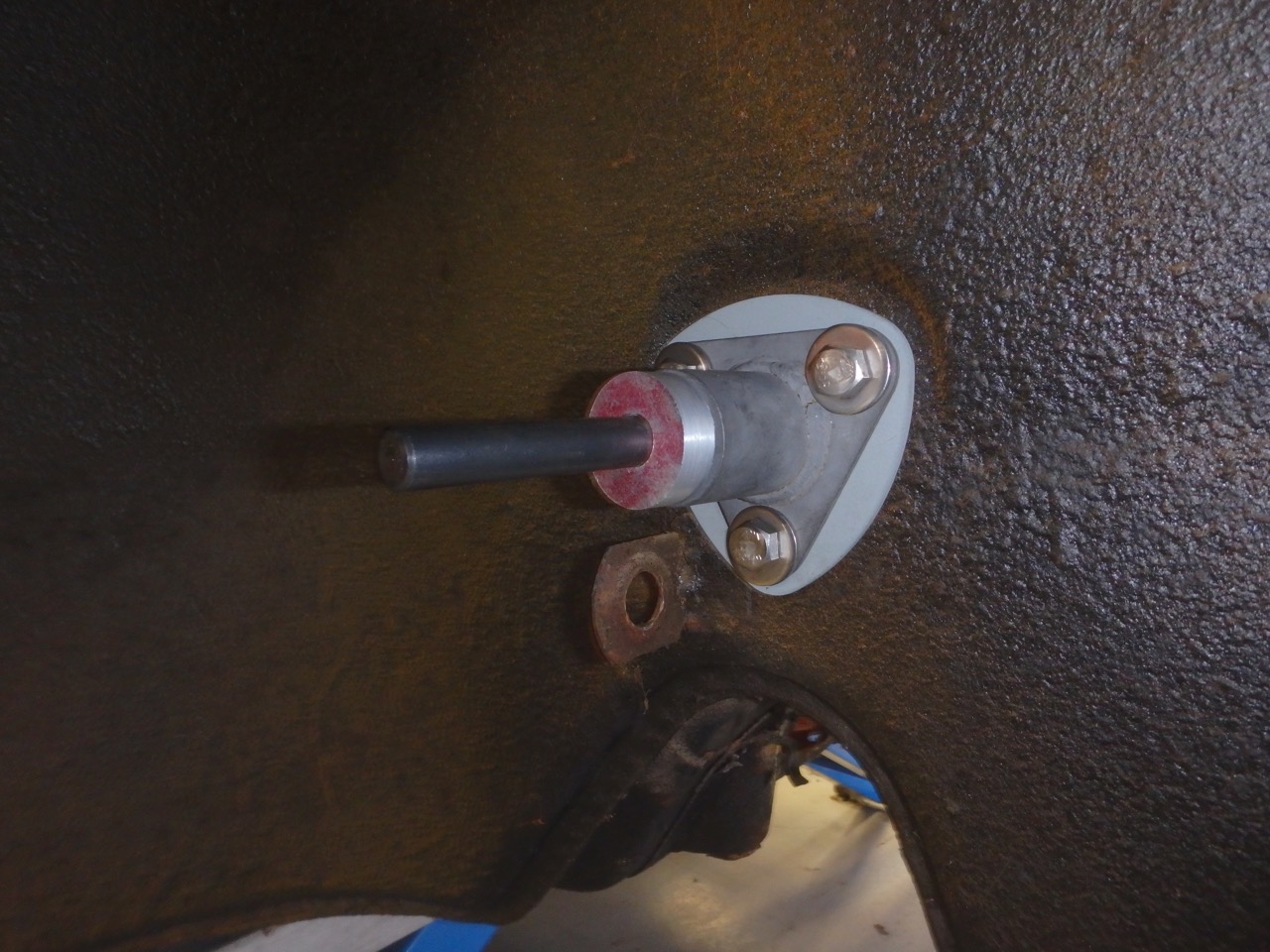

So then I need to mark the center one the swatbar location. Since I was missing time on my metal lathe, I turned a spacer down.
Fits like a precision glove, well because it is a precision fit.
Transfer punch inserted in the last picture , give it a few hits with the hammer, and disassemble the pieces one last time. Probably not (IMG:style_emoticons/default/dry.gif)

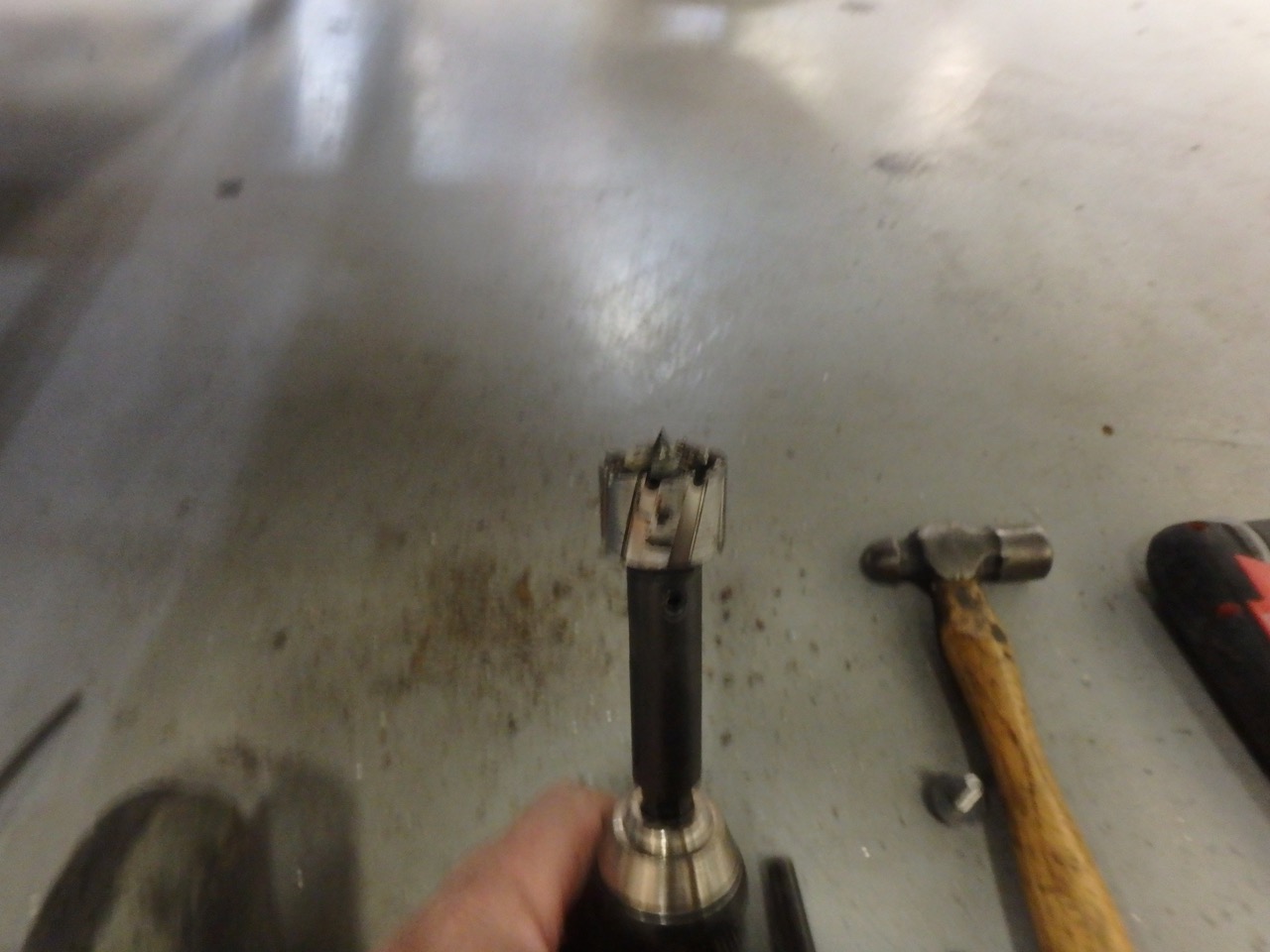

Drill a pilot hole and then drill the hole.
Tools of the trade to fit these, in a pile on the floor.
Small Ball Peen hammer
Socke wrench, extension and socket
Transfer Punches
Close Quarters drill - pilot holes
1/2 inch drill - step drill
Rotabroach to drill the big hole
Final Big hole drilled
And in place, well I', holding it in place, did not feel like bolting it all together to take it apart again.
Next up for this side is clean the undercoating. Scuff up the paint, and JB weld it to the car. Yes normally I would weld, but since I don't want to repaint, where the weld would burn off paint, it will be JB Weld. Brad says it will work, and I see no reason it would not work.
I tend to measure project success and the amount of fun I have had by the number of chips, pile of metal shavings, and metal abound.
Successful and fun day (IMG:style_emoticons/default/piratenanner.gif)

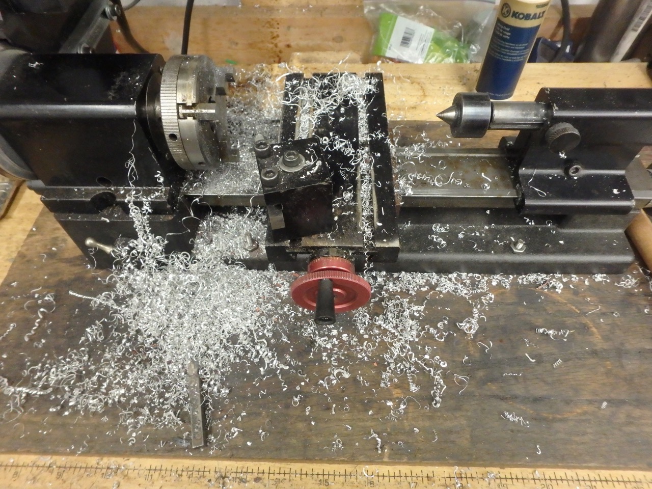

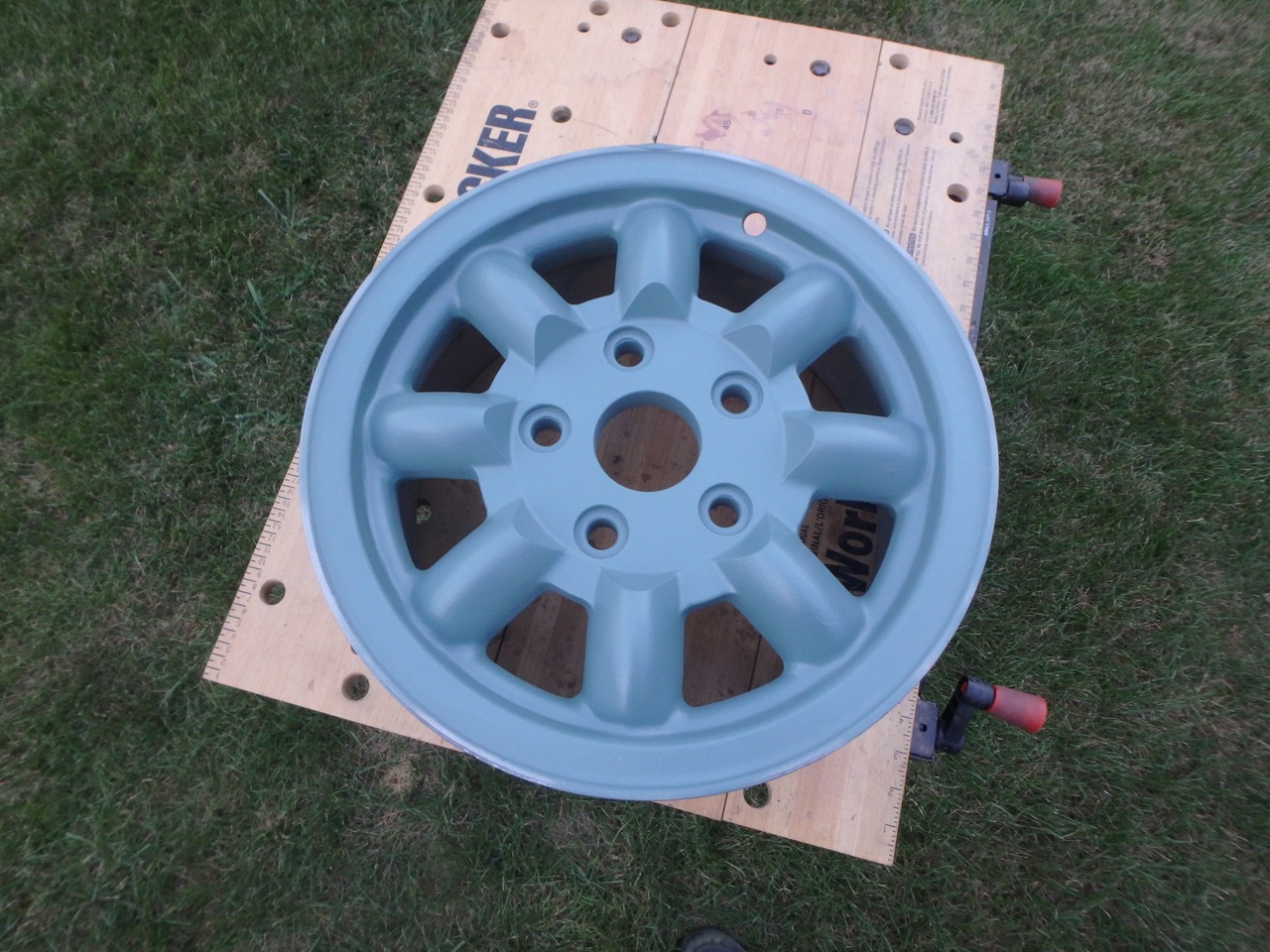

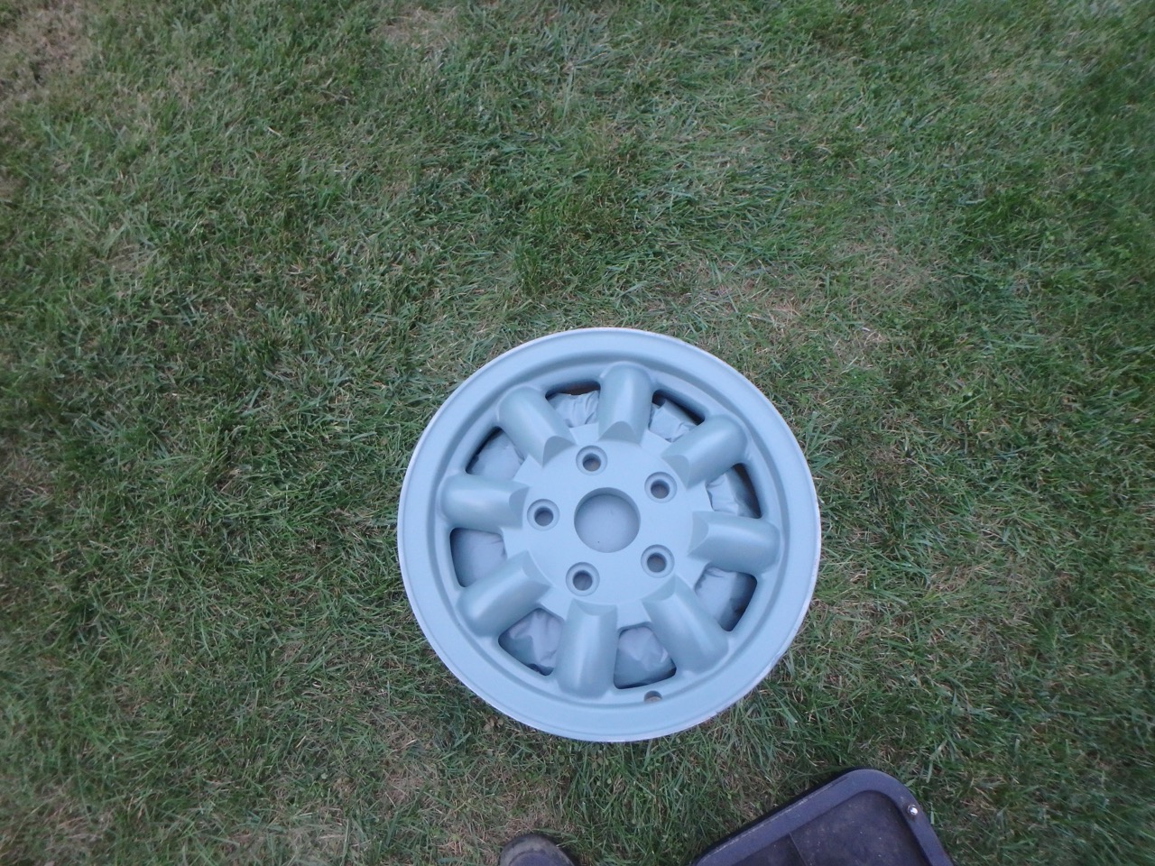

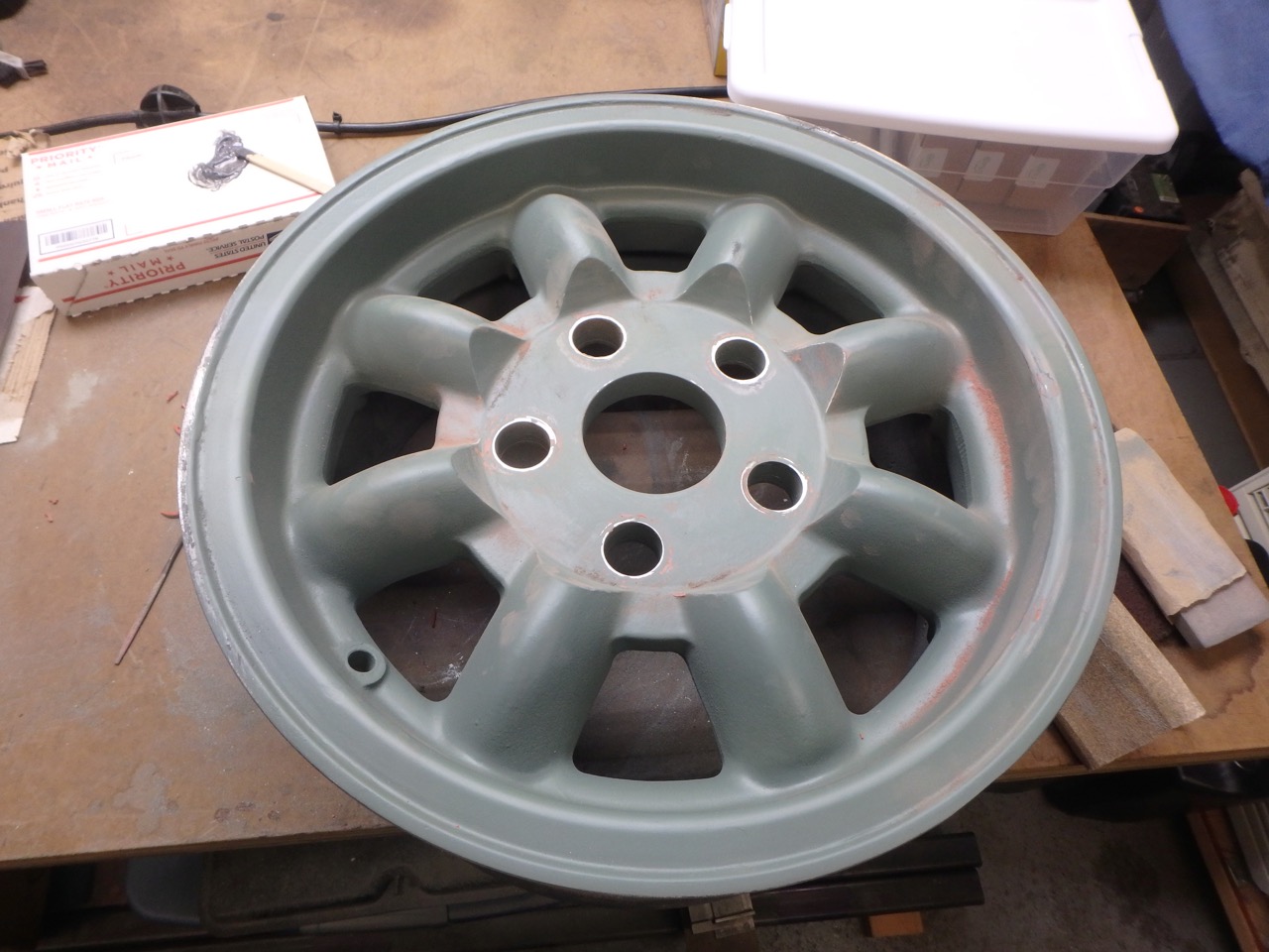

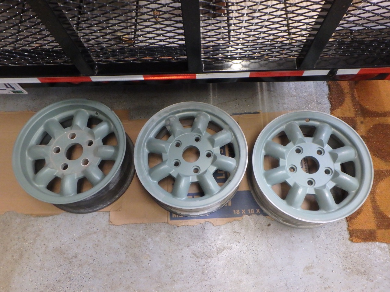

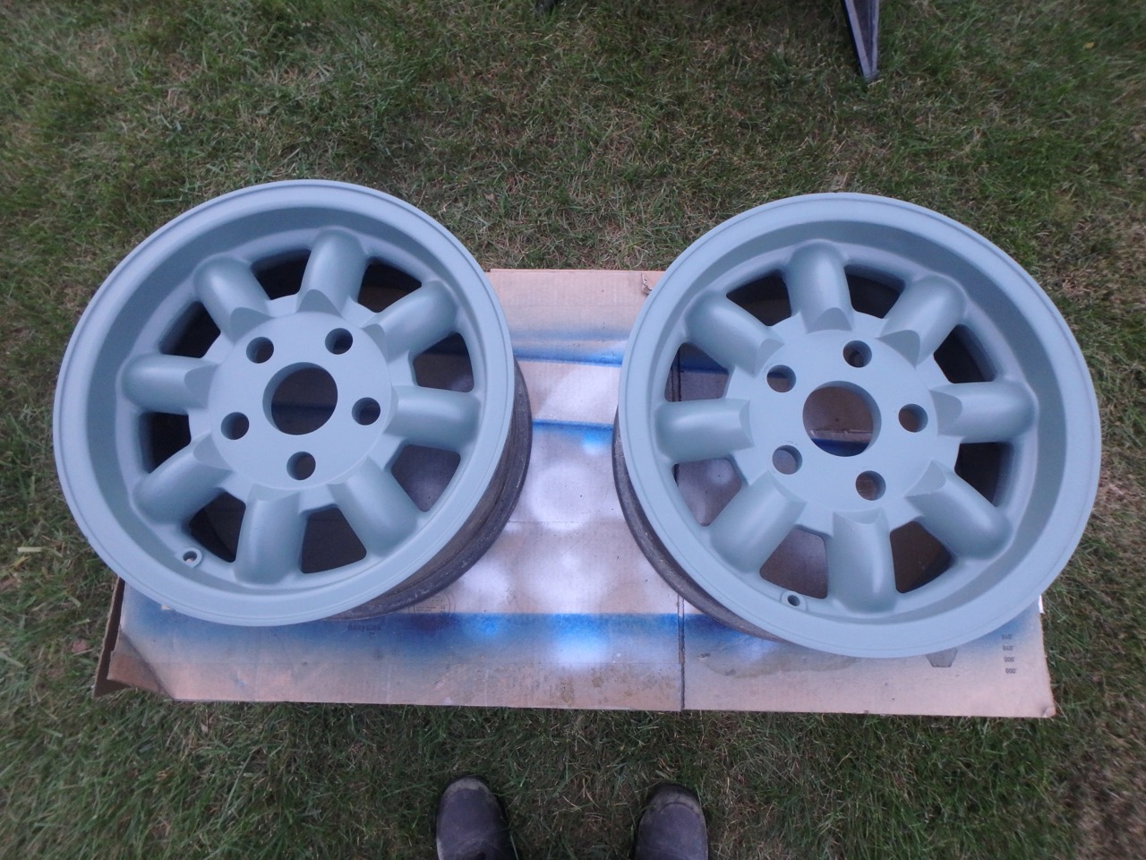

Oh the not fun part of my day, I have been working on one of the sets of MiniLites I have. Prepping for paint, as they where in good condition. But lots of small paint chips, and different colors. So following the instructions off a wheel restore that works on Ferrari Mag wheels I got to this point.
That one was sitting on my stool that turns, hate the stool, but it does a great job for painting wheels
And the last one, all where baking in the afternoon sun
Hope to get a bit more done on the wheels over the week, but maybe I will focus on the sway bar mounts and install. Would like to start having the car go back together.

QUOTE(914forme @ Oct 22 2017, 03:39 PM) *
Great little 3" lathe. I have the same one myself.
