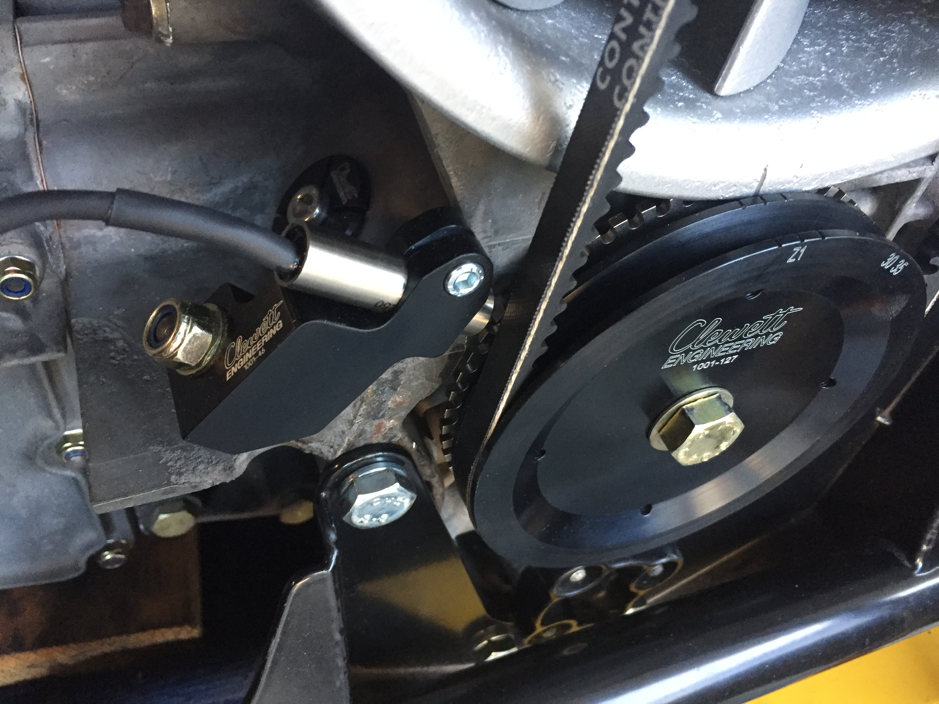

I have a 2.4 7R cased motor with Daugherty cams DC-30, we ported to 36mm and I'm using the Clewett crank-fire ignition.Attached Image
