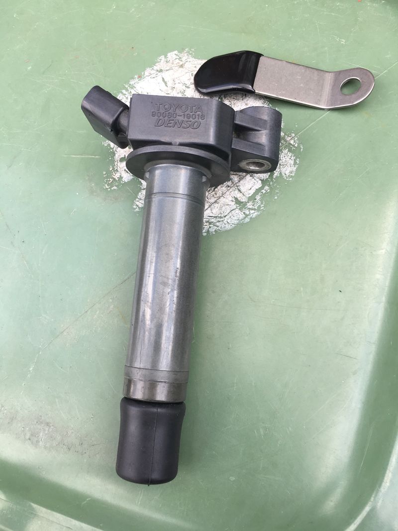

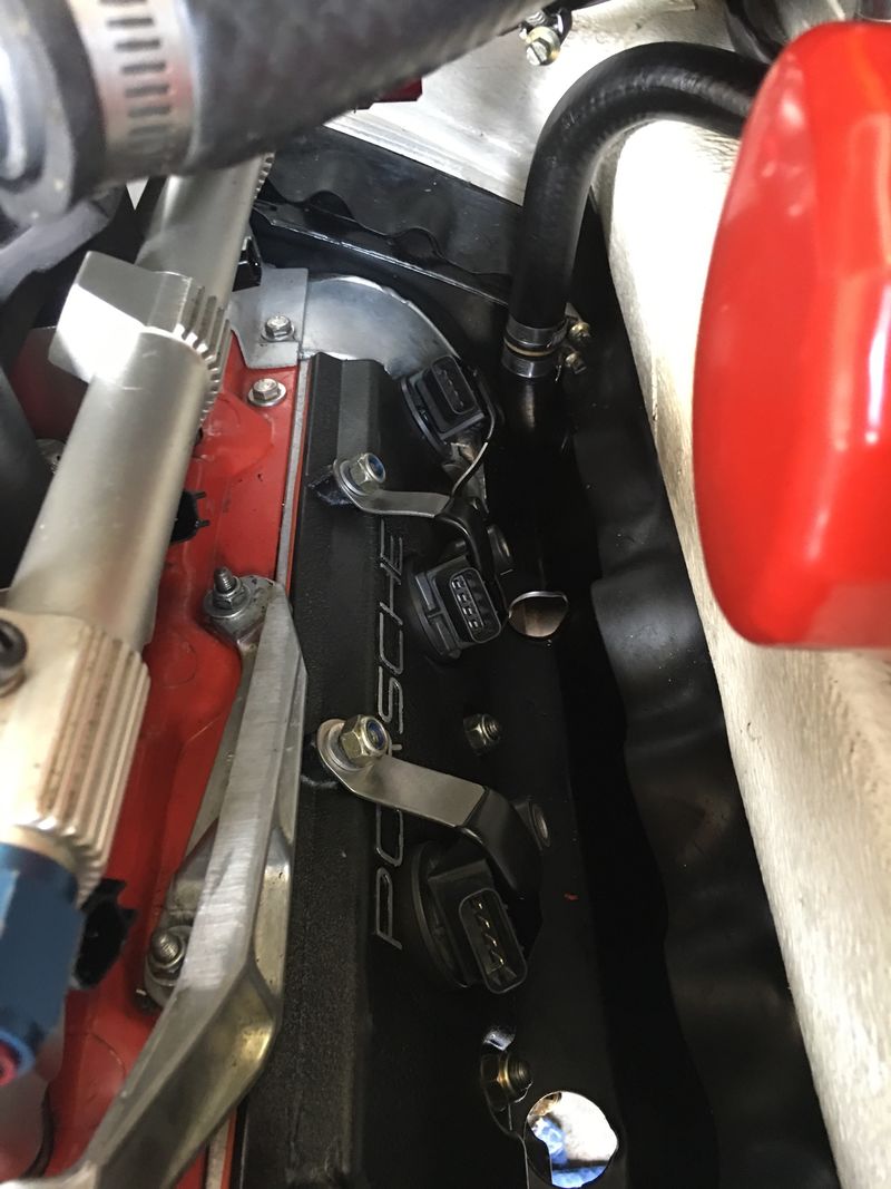

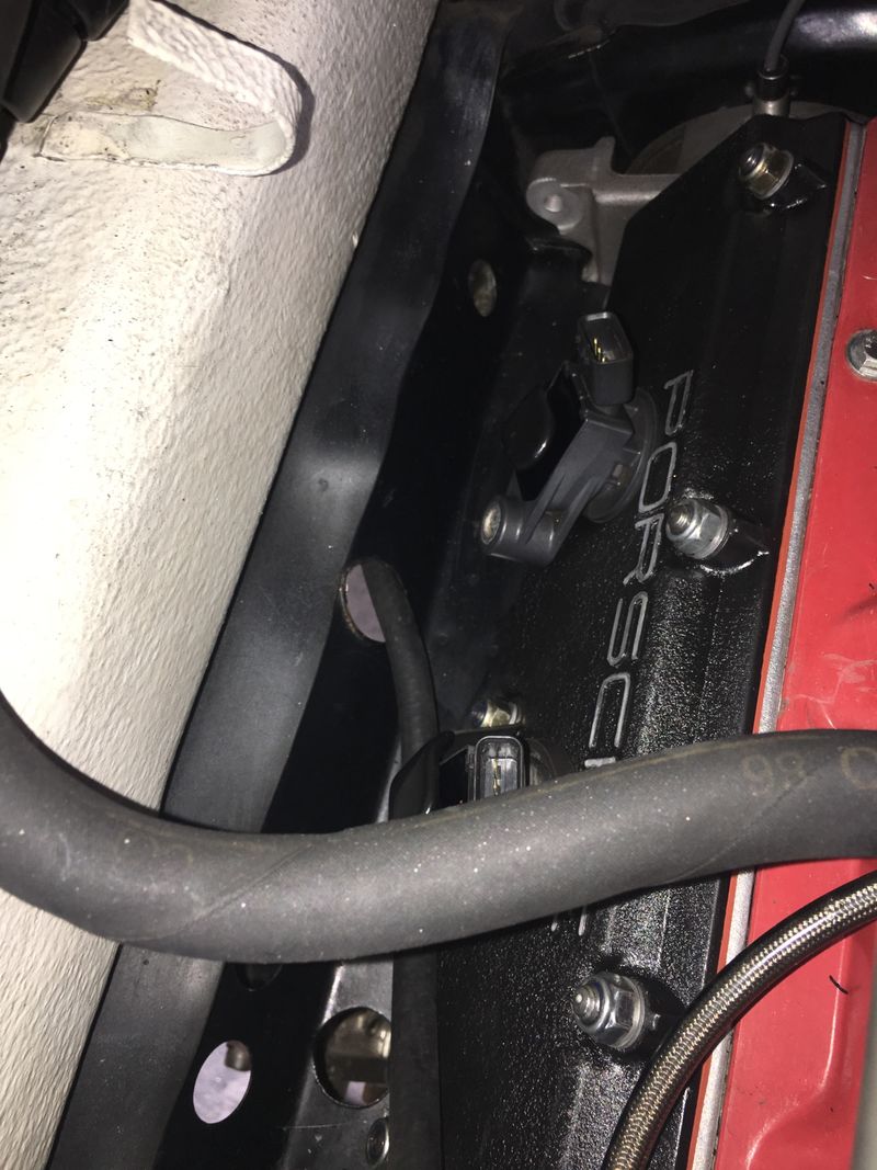

jfort   ended up fabricating a mount for the direct igniti...   May 31 2018, 10:50 AM
jfort   RE: Engine Rebuild   May 31 2018, 10:51 AM
jfort   RE: Engine Rebuild   May 31 2018, 10:52 AM

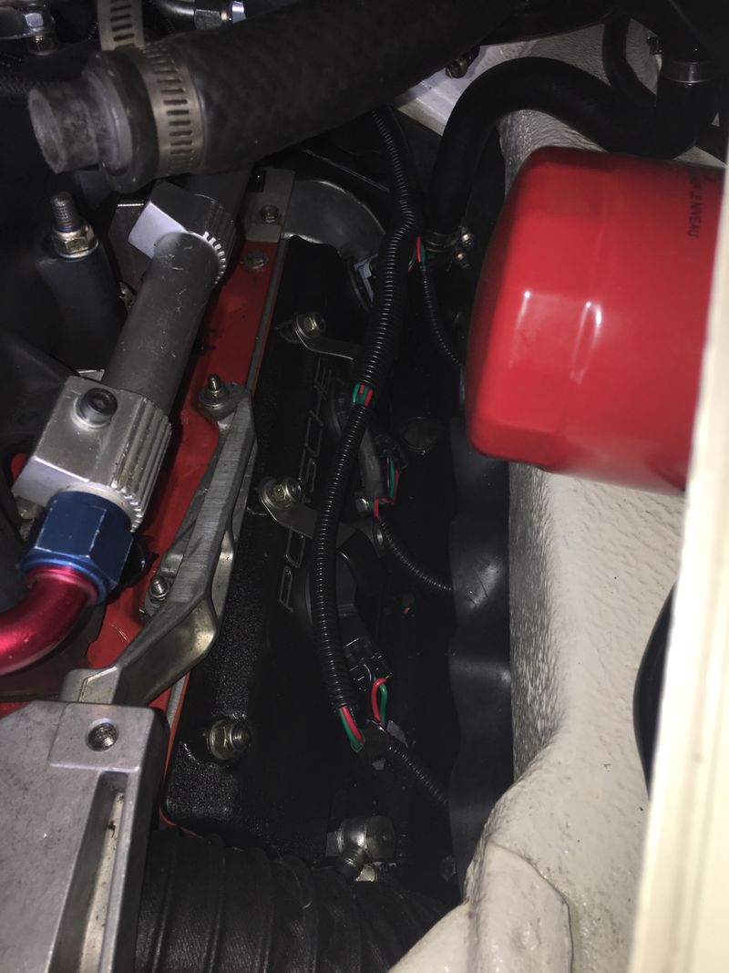

jfort   had to get the custom length wires through the tin...   May 31 2018, 10:53 AM
jfort   RE: Engine Rebuild   May 31 2018, 10:54 AM
jfort   note heat shrink on wire connections and the wire/...   May 31 2018, 10:55 AM
