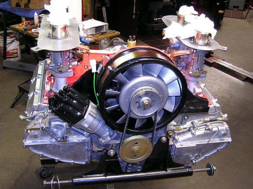

jfort   Jugs are back from Wisconsin with new nikisol. (Si...   Apr 8 2018, 03:56 PM
jfort   almost too pretty to put back in   Apr 11 2018, 03:16 PM

jfort   measuring and adjusting accelerator pump injection...   May 17 2018, 08:32 AM
jfort   getting close   May 17 2018, 08:34 AM
jfort   mating with the car starts Saturday   May 17 2018, 08:36 AM
