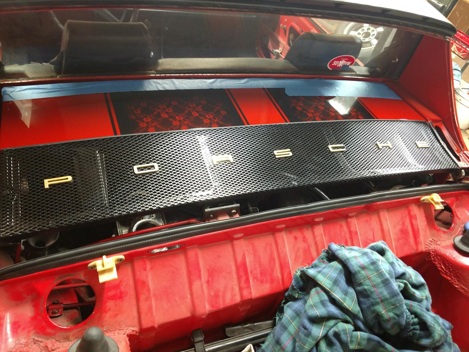

We had engine lid installed. Still have tape on, as it will come out one more time for the seal to go in,
Trunk goes in tomorrow,
(IMG:http://www.914world.com/bbs2/uploads_offsite/www.thesamba.com-17371-1513650840.1.jpg)

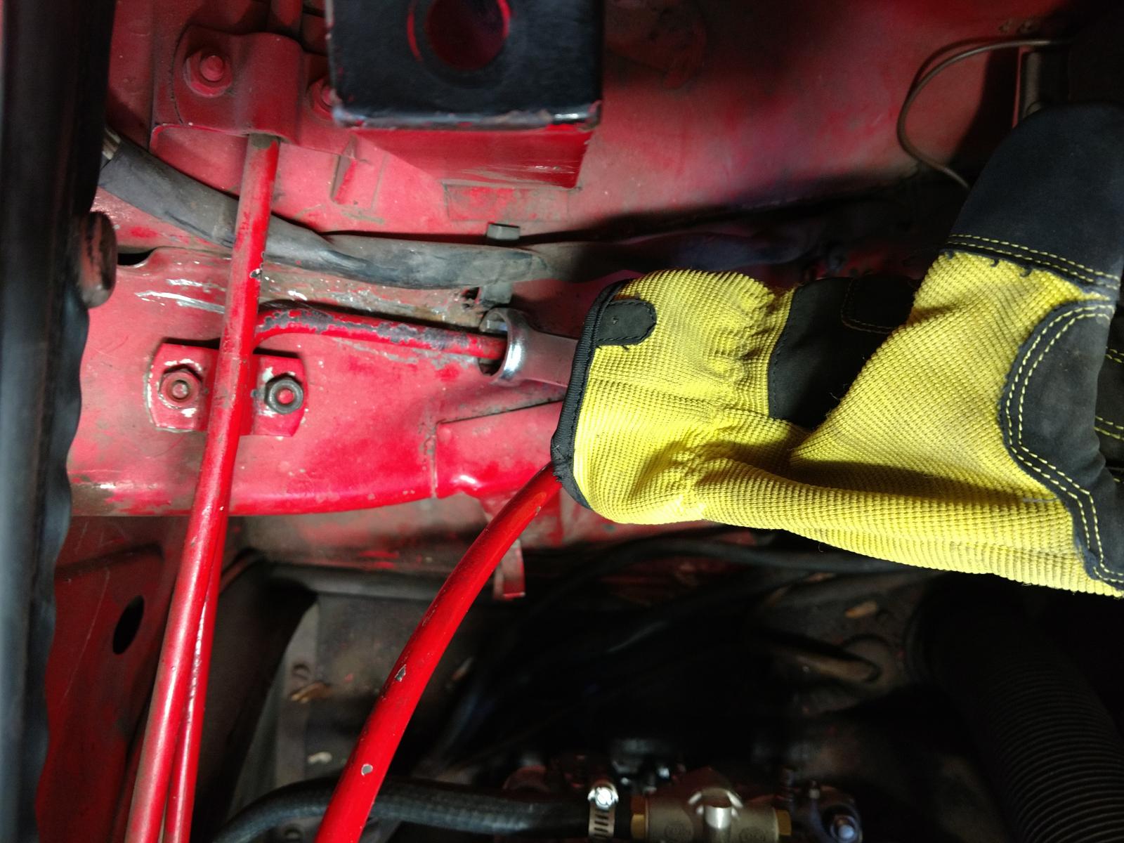

Pics of me getting the rear trunk tensioner rods leverazged back into place
(IMG:http://www.914world.com/bbs2/uploads_offsite/www.thesamba.com-17371-1513650840.2.jpg)

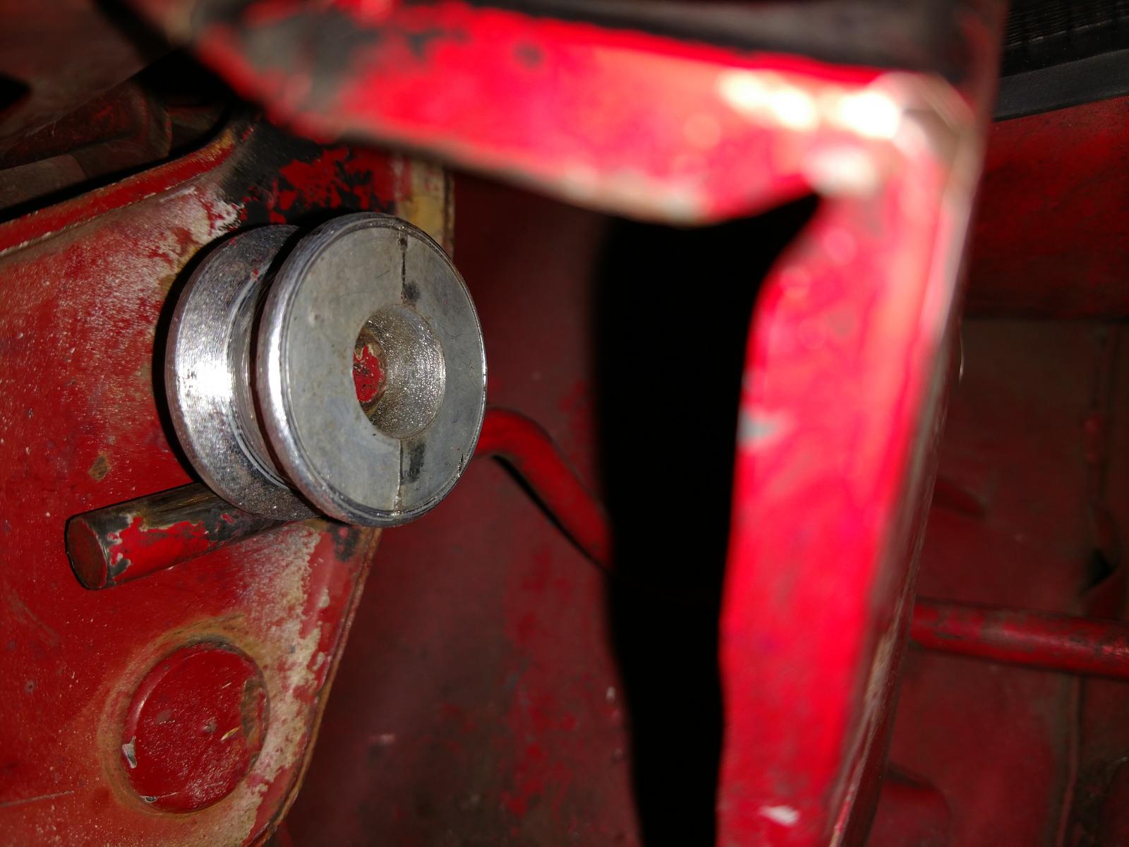

In the absence of any replacement rollers for the rear trunk roller, a little massaging with a lathe, and voila, function. (In final product, it is cradled in the groove.)

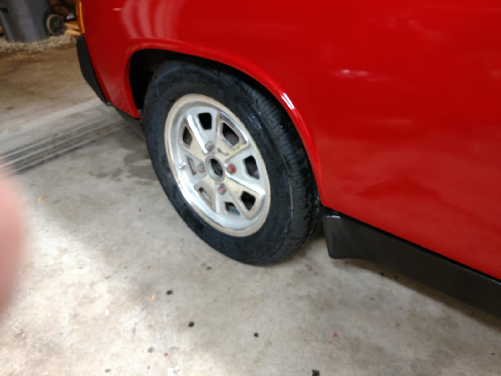

And lastly tonight, the Fuchs with 205/60/15. A little tight up front, but they do clear the shock.
