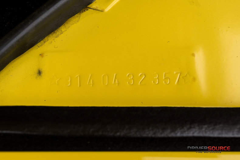

The Vin stamped in the front trunk appears to be stamped up from the bottom. Aren't they usually stamped down from the top? Or did that vary? Something's fishy.
Edit: Maybe optical illusion.

gulf908   and the trunk stamping looks a bit too tidy as wel...   Dec 20 2017, 05:01 AM
Mike Fitton   and the trunk stamping looks a bit too tidy as we...   Dec 20 2017, 10:58 AM
mepstein   It would be interesting to know what the trunk sta...   Dec 20 2017, 11:23 AM
