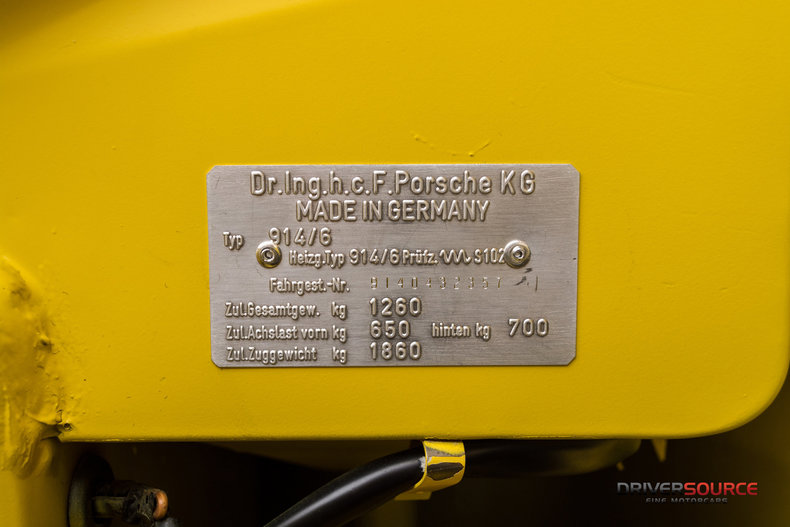

https://inventory.driversource.com/vehicles..._eid=b7e69f08c4

and the trunk stamping looks a bit too tidy as well .....

QUOTE(gulf908 @ Dec 20 2017, 03:01 AM) *
Dennis
That trunk ID plate is also a replacement, look at the vin stamping type font, its not even close to original!!

gulf908   and the trunk stamping looks a bit too tidy as wel...   Dec 20 2017, 05:01 AM
Mike Fitton   and the trunk stamping looks a bit too tidy as we...   Dec 20 2017, 10:58 AM

sbsix   Just noticed that the A pillar VIN tag is a poor r...   Dec 20 2017, 11:35 AM

Mike Fitton   Uh Oh!! This car is in the World vin data...   Dec 20 2017, 02:49 PM

Blue6   Uh Oh!! This car is in the World vin dat...   Dec 20 2017, 09:56 PM
sixnotfour   that tag is chemically etched, they were for sale ...   Dec 22 2017, 04:20 PM
