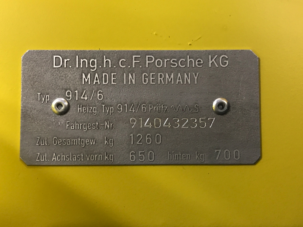

Uh Oh!! This car is in the World vin database with a warning about the ID plates and a picture is posted of the front trunk plate and it looks different. Looks like Auto Kennel had the listing back then.

Mike Fitton   Got to be a replacement sticker that is wrong my 2...   Dec 19 2017, 10:31 AM

bretth   The Vin stamped in the front trunk appears to be s...   Dec 19 2017, 12:02 PM
BENBRO02   The Vin stamped in the front trunk appears to be ...   Dec 19 2017, 09:11 PM
bretth   The Vin stamped in the front trunk appears to be...   Dec 19 2017, 10:26 PM
914z   The Vin stamped in the front trunk appears to be ...   Dec 20 2017, 01:29 AM
914z   The Vin stamped in the front trunk appears to be ...   Dec 20 2017, 01:43 AM

gulf908   and the trunk stamping looks a bit too tidy as wel...   Dec 20 2017, 05:01 AM
Mike Fitton   and the trunk stamping looks a bit too tidy as we...   Dec 20 2017, 10:58 AM
mepstein   It would be interesting to know what the trunk sta...   Dec 20 2017, 11:23 AM
sbsix   Just noticed that the A pillar VIN tag is a poor r...   Dec 20 2017, 11:35 AM
mepstein   It would be interesting to discover the past owner...   Dec 20 2017, 12:19 PM

Blue6   Uh Oh!! This car is in the World vin dat...   Dec 20 2017, 09:56 PM
sixnotfour   that tag is chemically etched, they were for sale ...   Dec 22 2017, 04:20 PM
