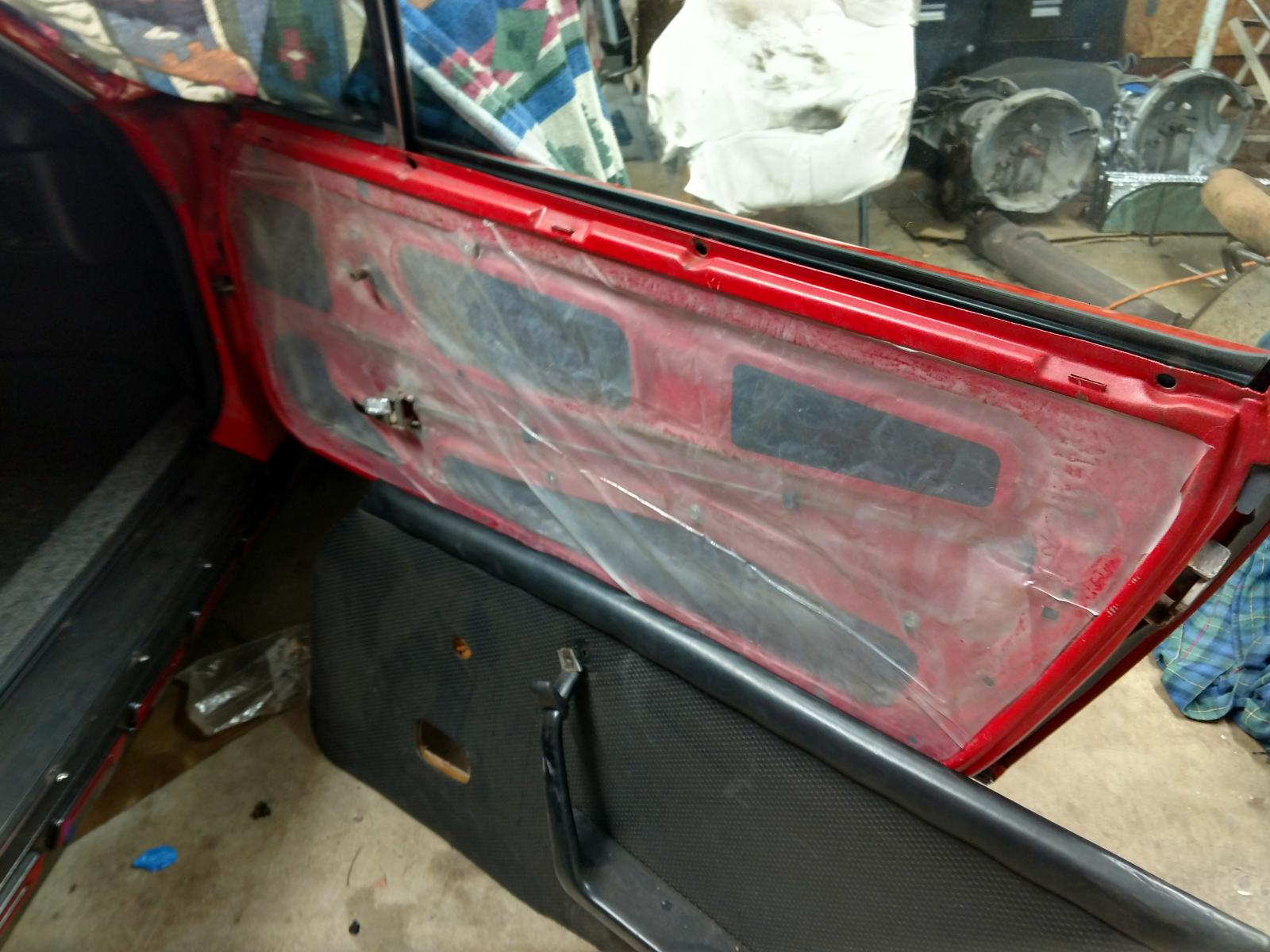

Got two runs at installing the doo cards. First time, after nearly all complete, realized that the fuzzy inner window scraper needs to be installed before the door cards. U install, install and reinstall
(IMG:http://www.914world.com/bbs2/uploads_offsite/www.thesamba.com-17371-1513990097.1.jpg)
After some construction projects, had leftover visqueen (sp) so, with some 3M adhesive, I’ve got a moistur barrier

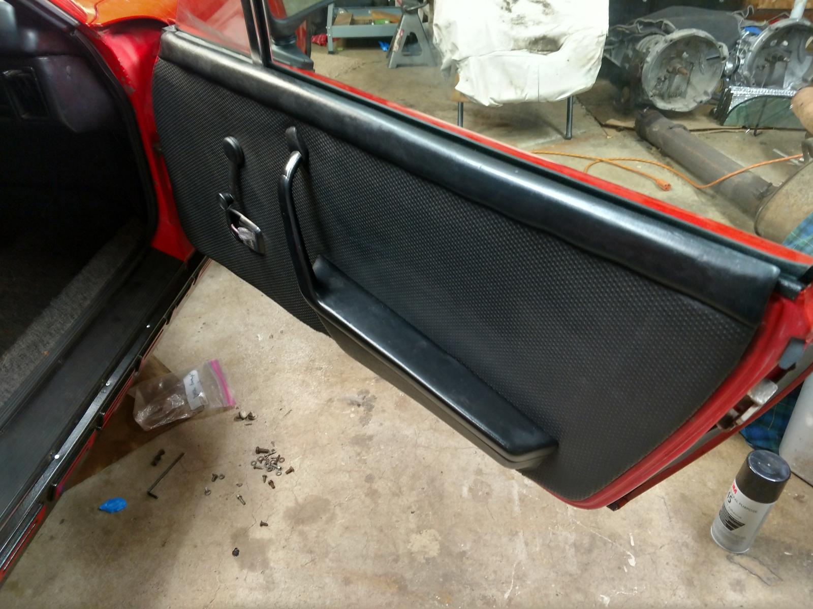

And the completed passenger side.
