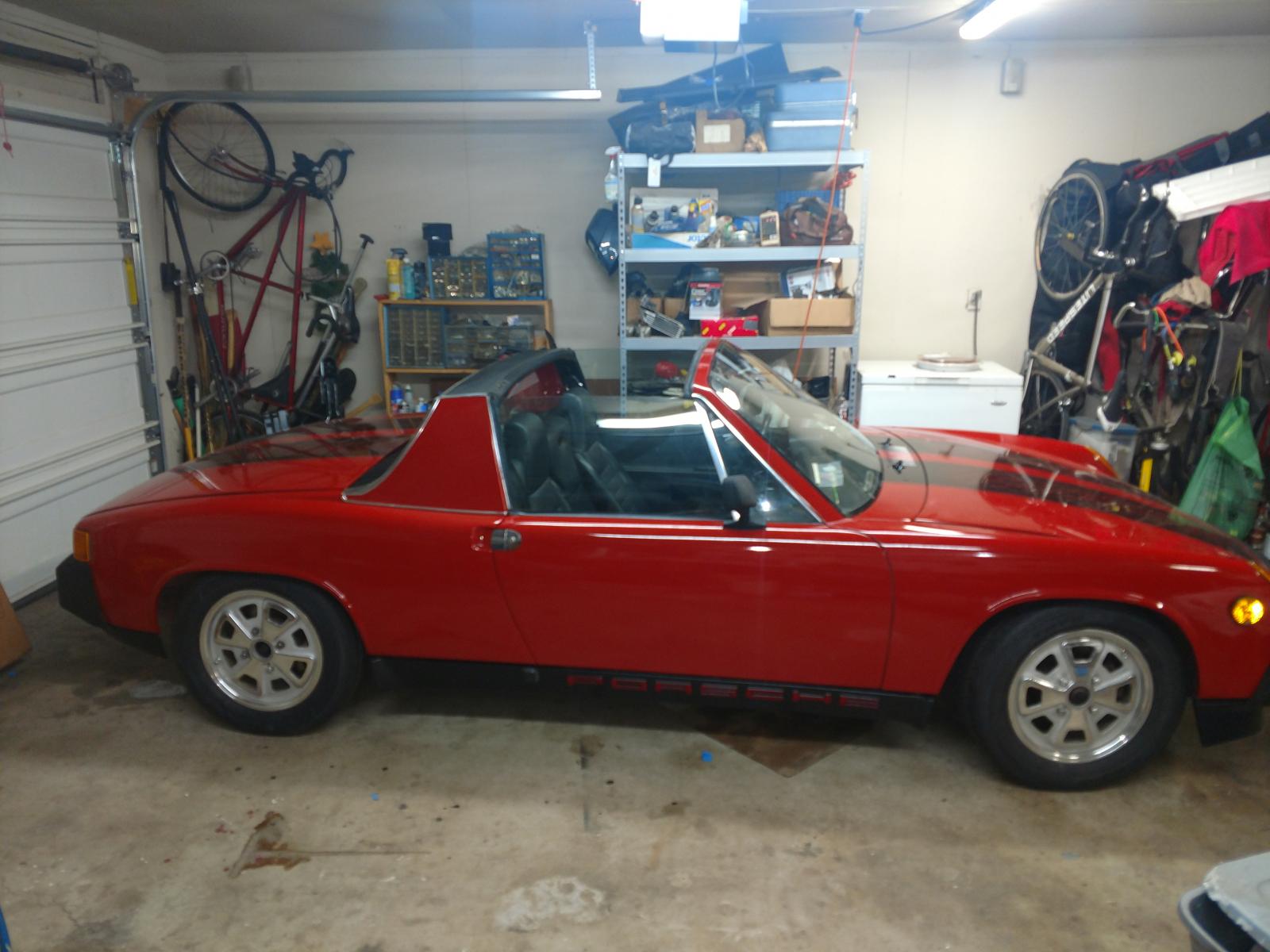

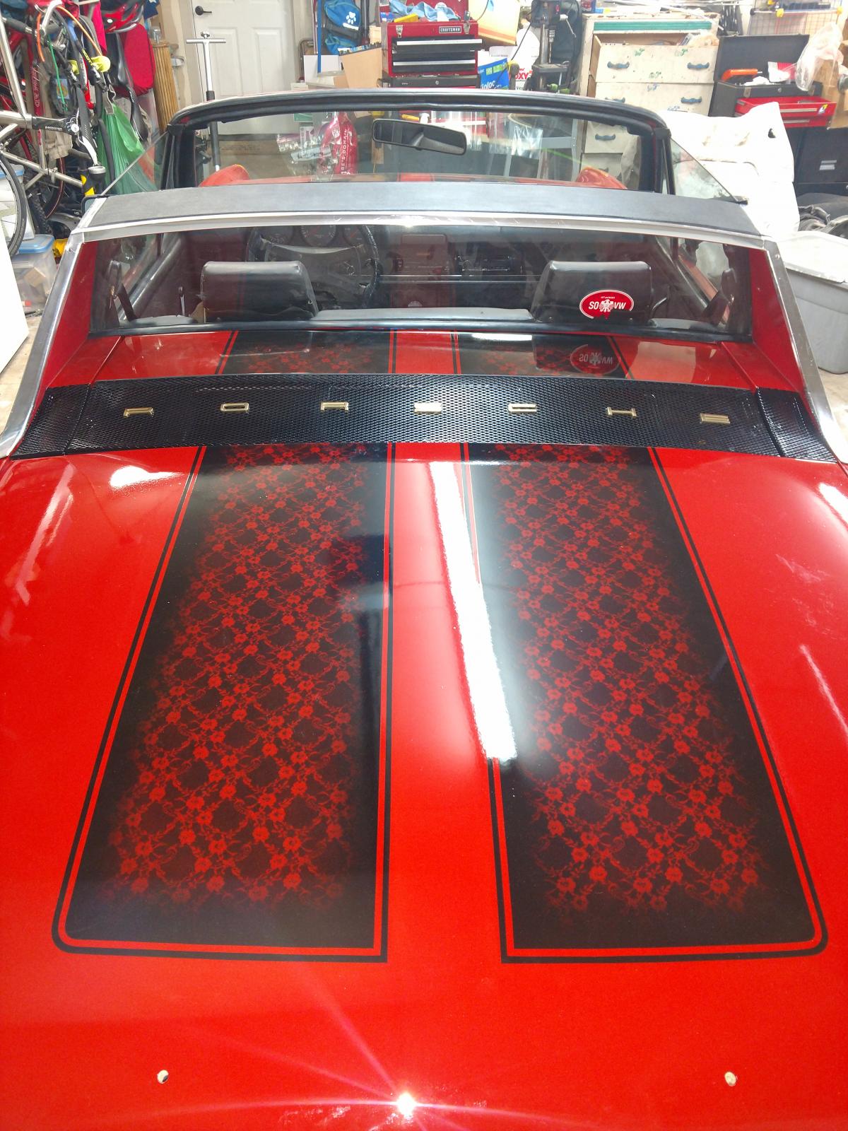

Sail trim on.
Rain tray installed. Only thing left on the rear is the spoiler. That should be done/painted after Xmas.

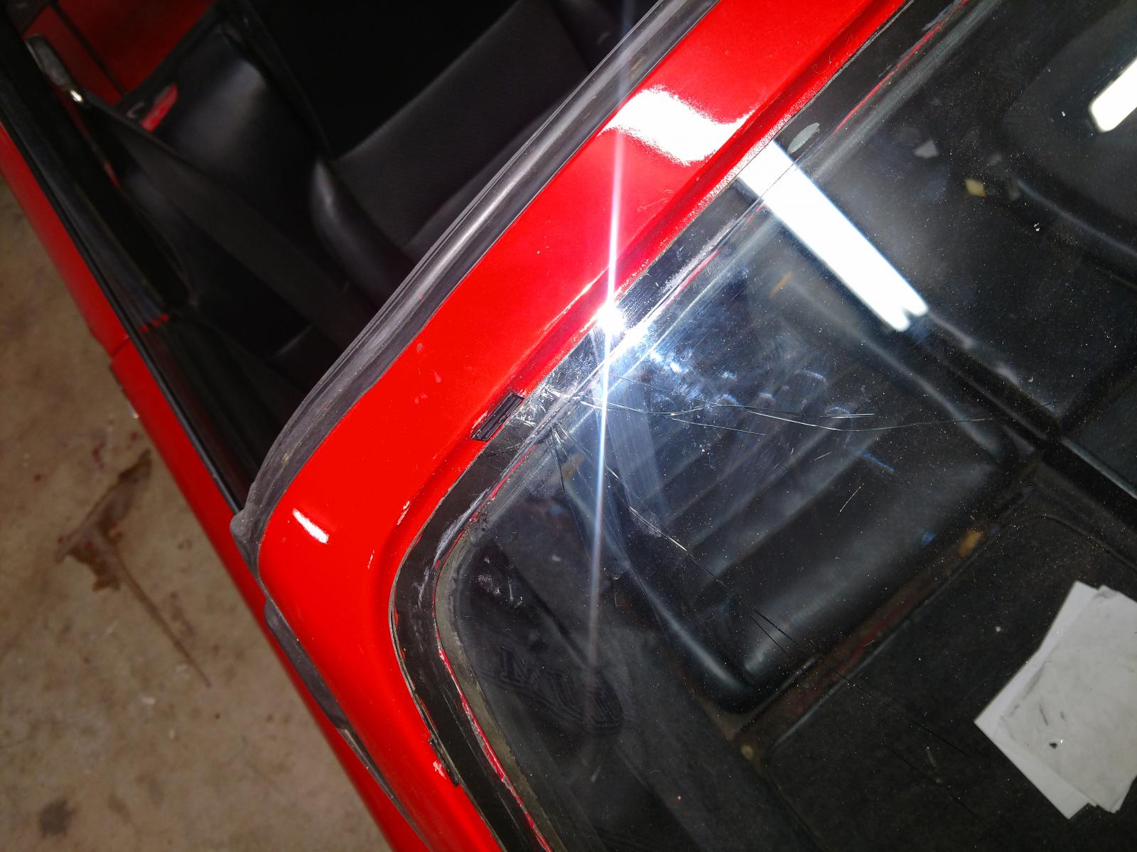

And one major thing.
Cracked while installing the trim. Old trim wouldn’t click in. Pushed a bit too briskly?
