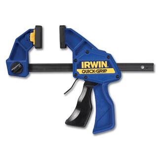

Next question.........I need to install the drop link cup bushings for the rear sway bar. I haven't a clue as to the correct way to accomplish the task. The sway bar is currently in the car, I just got the cup bushings yesterday. They look to be a nylon material.
Would ya'all be so kind as give me some direction. I'm sure it must be simple but keep in mind..........I ain't that smart. Best, mike |

No heat, hot water or drilling required. Just some grease and a one handed bar clamp capable of about 300 lbs of force.
(IMG:http://www.914world.com/bbs2/uploads_offsite/www.irwin.com-9101-1514387278.1.jpg) http://www.irwin.com/tools/clamps/sl300-on...lamps-spreaders |
