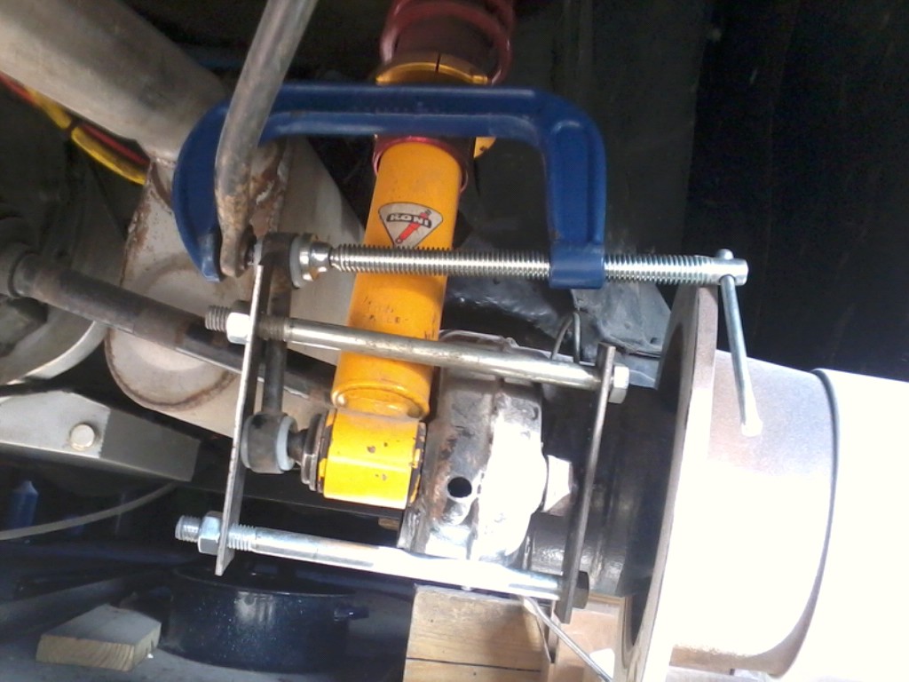

Here's what I did. Cheap and worked like a charm

914Sixer Drop them in boiling water. Handle with care. Ma... Dec 24 2017, 08:02 AM
cal44 Welp......I tried the boiling water several times.... Dec 24 2017, 03:26 PM
cary Got busy and forgot to post.
Lube with NAPA Sil-G... Dec 24 2017, 05:22 PM
Dave_Darling I used a vise to press the bushings into the drop-... Dec 24 2017, 08:59 PM
SirAndy I drilled a small hole in the backside of the plas... Dec 24 2017, 09:47 PM
76-914 I almost posted a How To last week. Very simple. I... Dec 26 2017, 04:33 PM
tomeric914 No heat, hot water or drilling required. Just som... Dec 27 2017, 09:07 AM
Mblizzard Just to add a bit. While very crude this is an ext... Apr 13 2018, 08:05 PM
