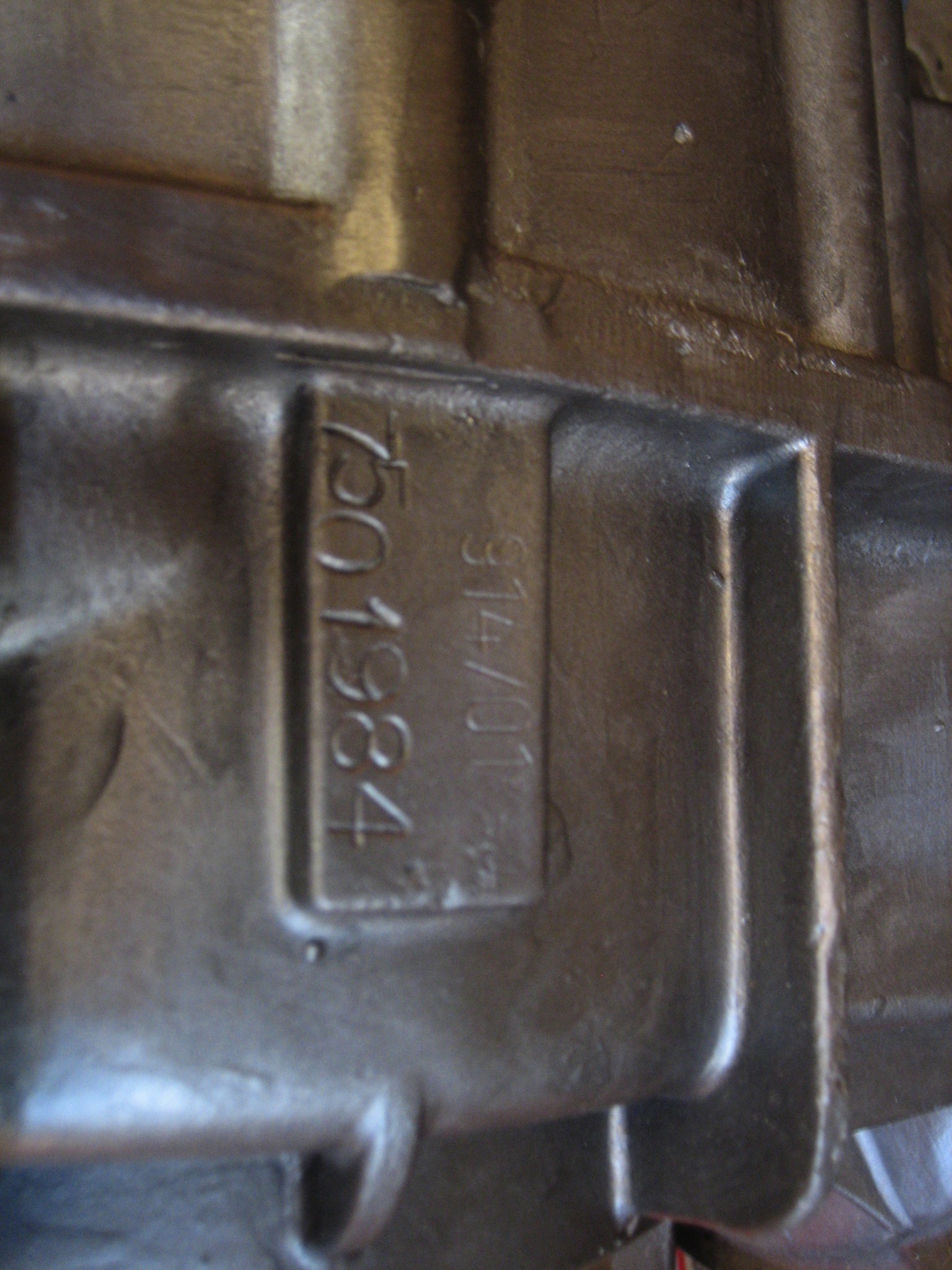

Cairo94507
post Dec 28 2017, 09:24 AM
Michael
Posts: 10,610
Joined: 1-November 08
From: Auburn, CA
Member No.: 9,712
I just know that the Six transaxles had the serial number on a flat section next to the spine of the transaxle. Here is mine:

Cairo94507   I just know that the Six transaxles had the serial...   Dec 28 2017, 09:24 AM
