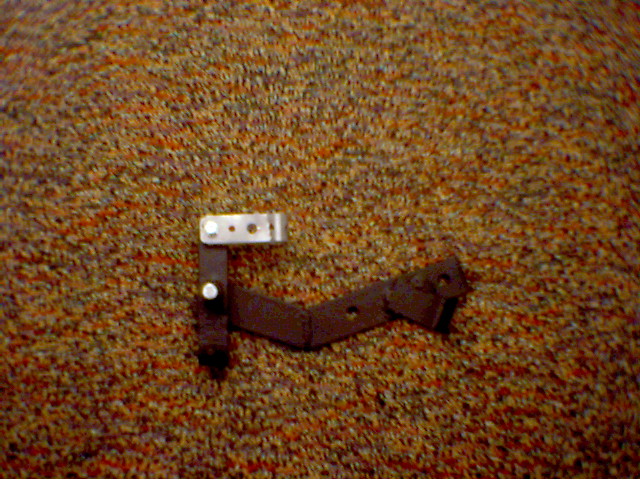

It has been a little while, But I did promise I would come back and better explain the bell crank throttle linkage for folks. All I did was stumble upon something that happened to work perftect. Well, I have made a few in the past, but this one I like the best of them all. So this weekend, I made 5 of them! I brought one to work with me this morning and will see if I can post the dimensions of this cool product. I am selling these for $60 plus shipping and will post in the appropiate place. (IMG:style_emoticons/default/biggrin.gif)

Root_Werks   It has been a little while, But I did promise I wo...   Nov 8 2004, 09:14 AM
