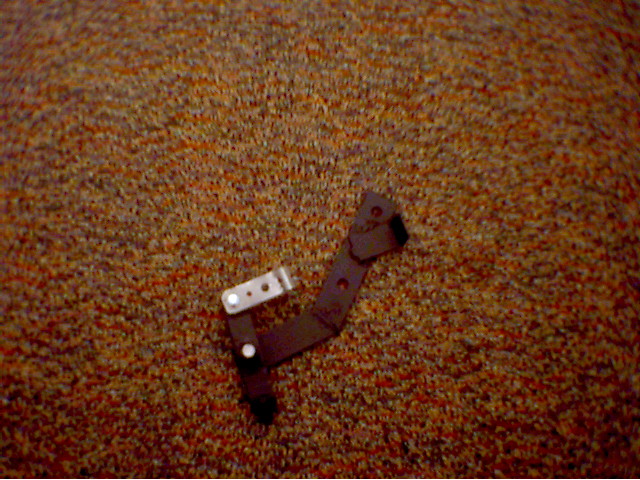

As before, you can see I am still using my ceral box digital camera. (IMG:style_emoticons/default/laugh.gif) Oh well. (IMG:style_emoticons/default/biggrin.gif) The set mounts on the pass. side of the trans cover. You simple remove 2 nuts, slip this on and put the nuts back on. It also uses the stock 914-4 throttle cable so you don't need to buy anything but my kit! Sweet huh? (IMG:style_emoticons/default/cool_shades.gif) Not pictured in these is the rod that goes from the bell crank to the carb linkage. Oh, this should work exactly like the factory one as in works with carbs, MFI and CIS engines. I am sure it would work with DME engines, but you might have to modify the rod?
