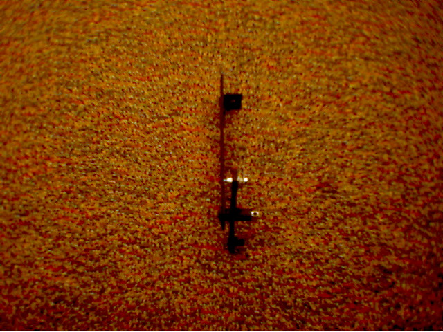

Okay, so this is about the 5th 914-6 conversion I have done. They are all drivers to this day. Heck, Even Craigh Laughlin has one of my old ones! My goal is to put as many 914-6's out on the road as possible since I think that is what the desing intended for them to be anyway. Anyway, I have heard soem thoughts about costs or how hard it is to convert. Nah, just time really. yeah, a few parts, but mostly just some time. Lets visit the part$ shall we. You will probalby need the following (as in not worth making):
Tank - Lots-o-options, but don't spend over $500 on one
Headers - $450 - 500
Mount - Zowie! Lots-o-options here as well. I have a jig to make my own, it works, but takes time. It is not hard, but takes a lot of time. I gave up and grabbed a patrick moly mount just today. I am running out of time.
Everyting else, you can make or do yourself. I will show you how in this thread over the next couple of weeks since that is all the time I have left!
Here is a shot of the holes drilled for the oil tank. Yep, I am using a Vellios tank yet again. They work great and use the later filters. Also, you can go down to your local industrial supply shop and have them make the pressure hose for like $40. The suction hose is even easier, but more on that later.
