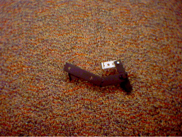

Root_Werks   So I welded 2 small pieces of steel brackets toget...   Aug 11 2004, 08:32 AM
Root_Werks   So here is yet another sucky shot of the rod I mad...   Aug 11 2004, 08:43 AM
