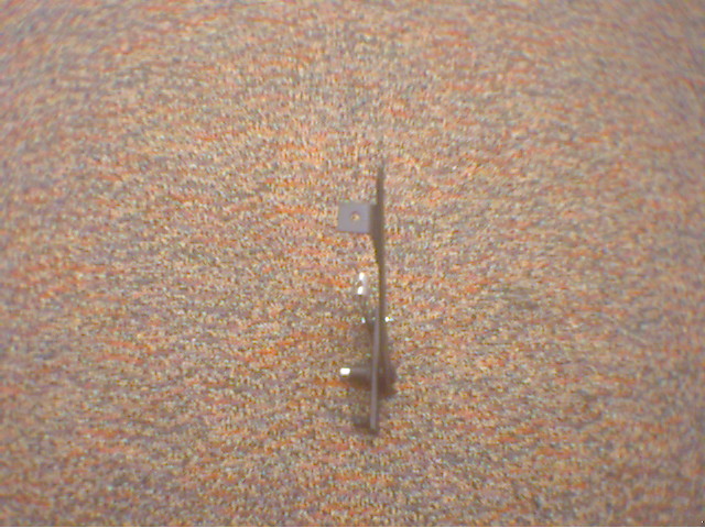

Root_Werks   It has been a little while, But I did promise I wo...   Nov 8 2004, 09:14 AM
Root_Werks   As before, you can see I am still using my ceral b...   Nov 8 2004, 09:18 AM
Root_Werks   More shots, do your eyes hurt yet? :evilgrin:   Nov 8 2004, 09:22 AM
Root_Werks   More   Nov 8 2004, 09:22 AM
Root_Werks   Last one. I will see if I can draw some sort of p...   Nov 8 2004, 09:23 AM
