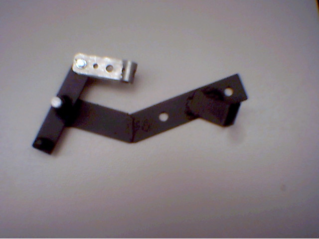

QUOTE(michel richard @ Nov 8 2004, 07:49 AM)
Thank you for all you arcontributing. I must say, however, that pictures on a better background would be even more helpful.
A small drawing with dimensions would be extraordinary.
Thanks
Michel Richard
914 2.2 E MFI
$20 dig camera on a carpet background, what's the problem? (IMG:style_emoticons/default/laugh.gif) Oh okay. From the top of my file cabinet:
