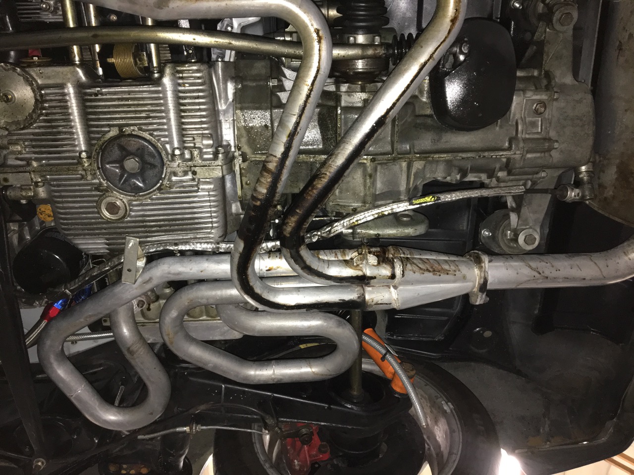

Mechanic road tested my car and didn't get the clutch to slip. The clutch slipping problem seems to happen less often than a couple months ago when the car first came here. What could cause that?
The engine seems to run nicely with the new Dellortos ... no idea why it's underperforming on the dyno. Here's the exhaust system. We're having a hard time figuring out exactly where the leaks are coming from. Someone else said he also smells transmission oil burning on the exhaust (it smells different?). The transmission fluid level was slightly lower than the opening when we checked it today.

Krieger   If it is tranny fluid It looks like it coming from...   Jan 10 2018, 09:39 PM
Perry Kiehl   First thing to do is figure out the leaks.   Jan 10 2018, 09:40 PM
MarkV   Looks wet.... gear oil has a distinct smell kind o...   Jan 10 2018, 09:47 PM
98101   Looks wet.... gear oil has a distinct smell kind ...   Jan 11 2018, 02:34 AM
ottox914   Rear main, trans out put, or ball pivot could all ...   Jan 11 2018, 07:28 AM
Vacca Rabite   Trans out. Flywheel off. Show us your rear main se...   Jan 11 2018, 08:41 AM
98101   You guys are probably right that the rear main sea...   Jan 11 2018, 10:42 AM
Dr Evil   You guys are probably right that the rear main se...   Jan 11 2018, 10:53 AM
MarkV   Isn't there a known problem with Erling rear m...   Jan 11 2018, 11:30 AM
Mueller   I've used the UV leak detector kits with succe...   Jan 11 2018, 12:27 PM
98101   I tried to smell the stuff today and it just smell...   Jan 11 2018, 09:00 PM
