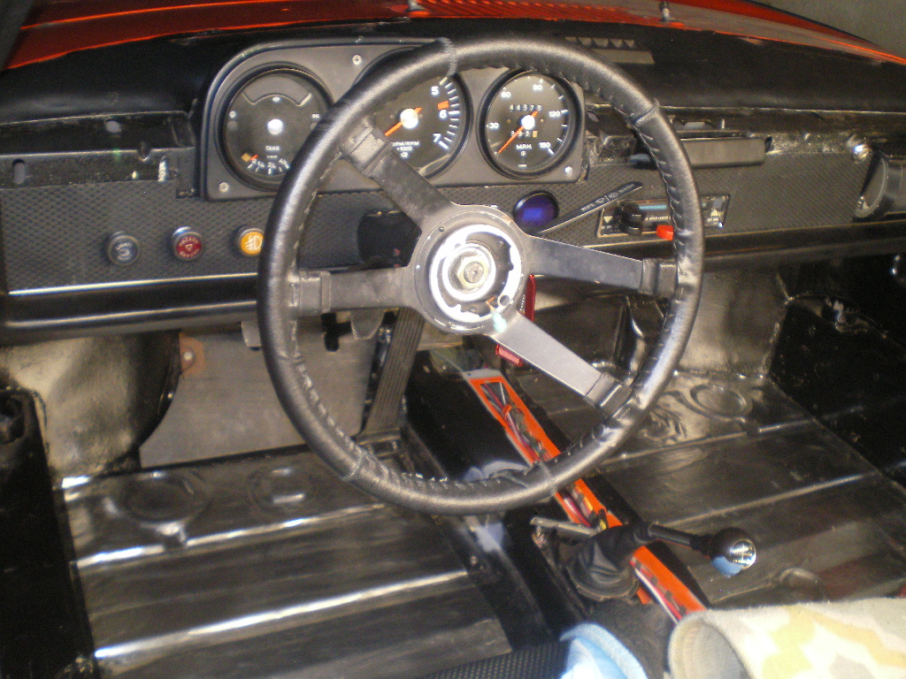

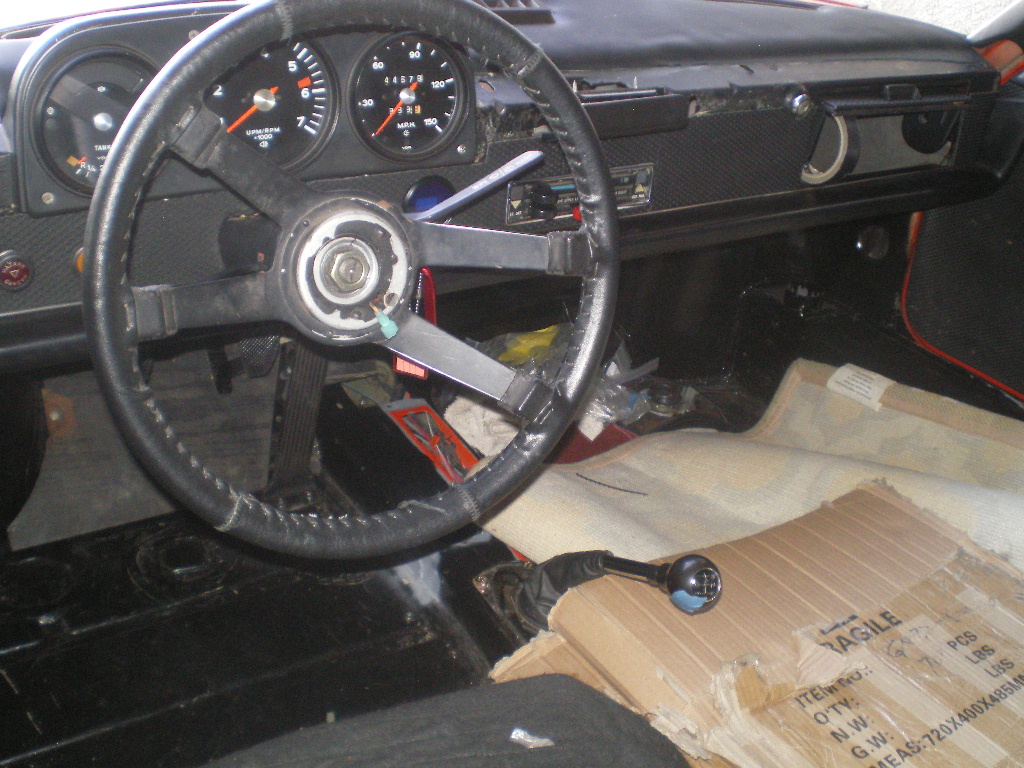

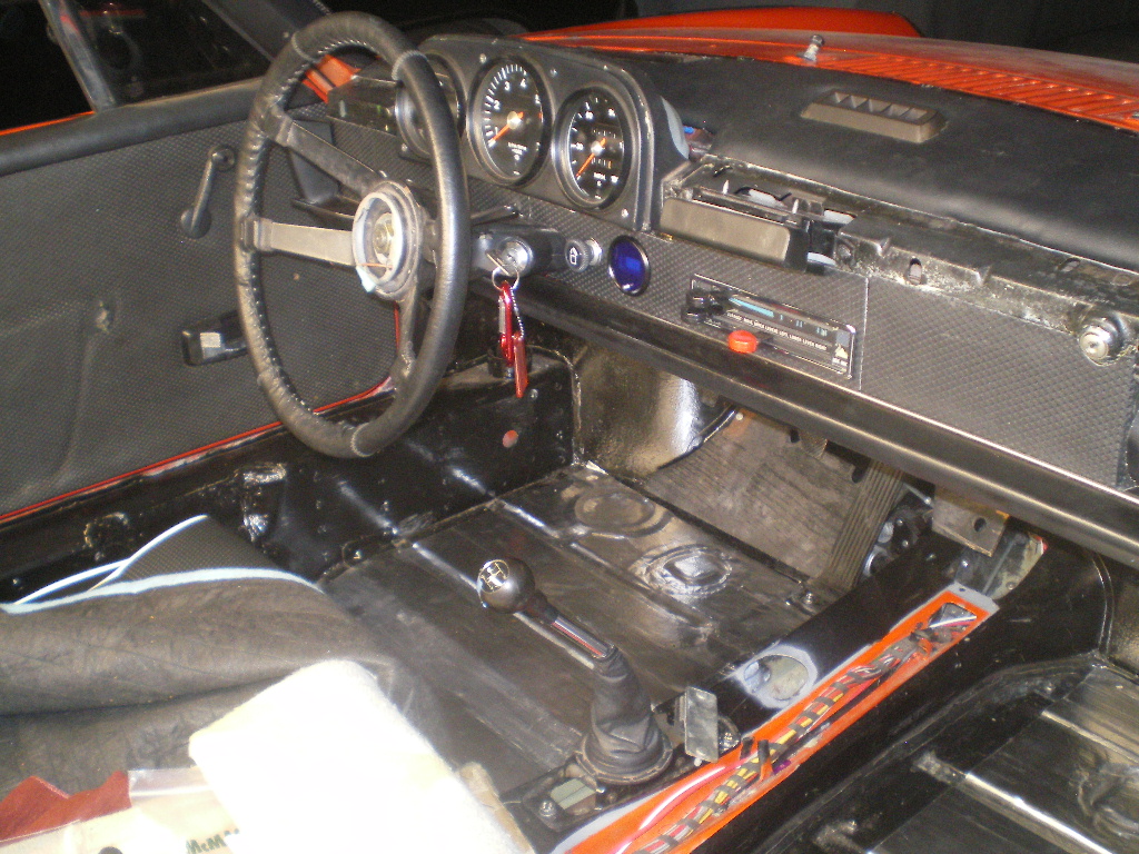

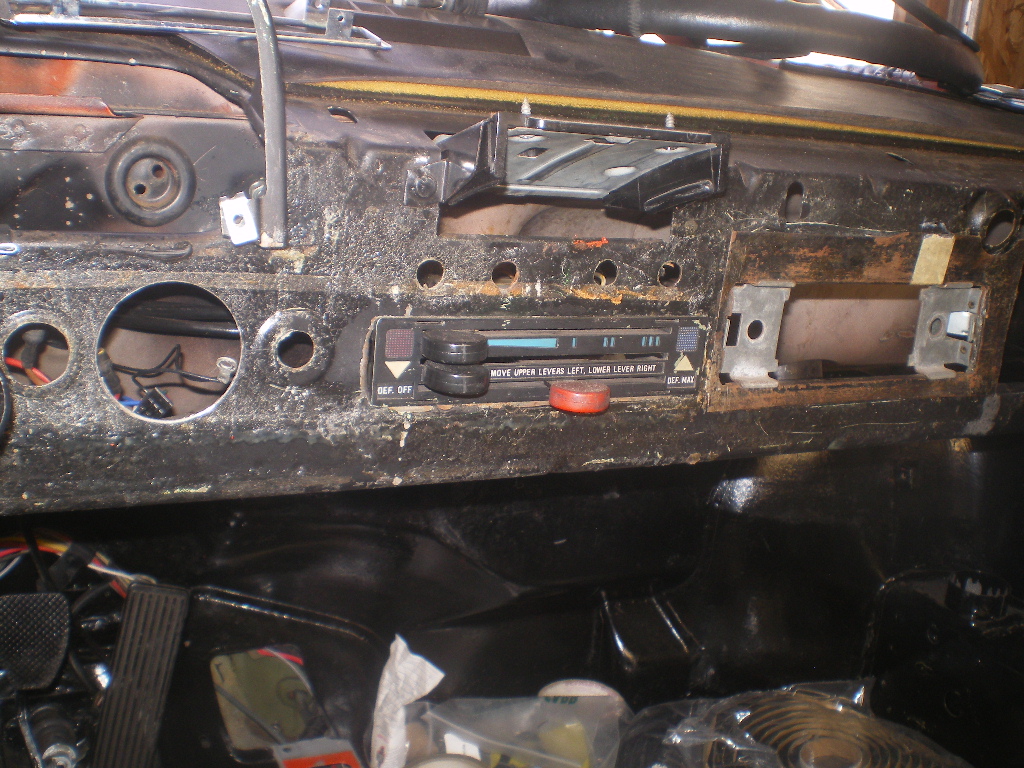

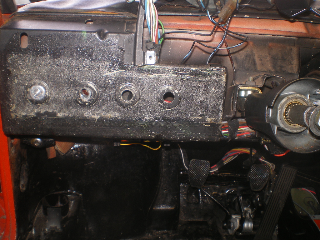

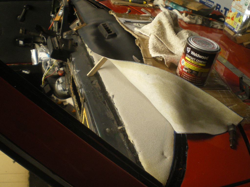

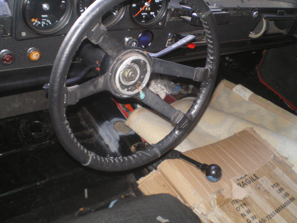

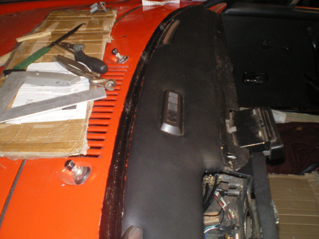

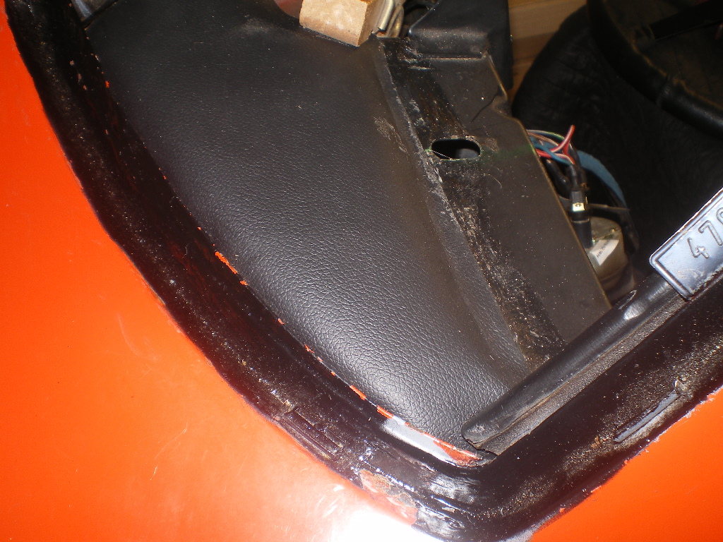

I don't think mine will ever see a race track. Maybe some spirited driving. So I've gotten a bit further. I didn't want to destroy a perfectly good air box so I worked around the existing vent. Took longer to work the material into place but much easier than removing the air box.
Installed some new dash face material then reinstalled the switches,Quad gauge and cigarette light. There will be no radio.
