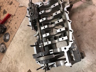

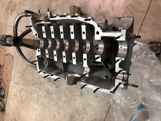

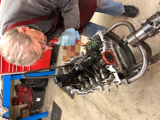

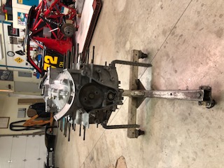

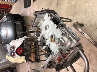

Making progress. Took the heads up to Craig Barrett in Grand Rapids MI who will be drilling twin spark holes. Then, yesterday, Jay Kjoller started the rebuild with yours truly lending a hand and trying to soak up as much of his extended knowledge as I can. Turns out that the casting mark says the case was cast in June, 1966. Put new bearings on the newly machined pistons rods. Then new bearings for the crankshaft. Jay is very deliberate and meticulous. It looked like medical surgery, very clean. Loctite flange sealer then the case halves mated. All new fasteners torqued to spec in 3 phases.
When we get the heads back, we will calculate the compression ratio. May do the JE pistons as posters here have suggested, depending on what we find. Going with a modified Solex cam.
