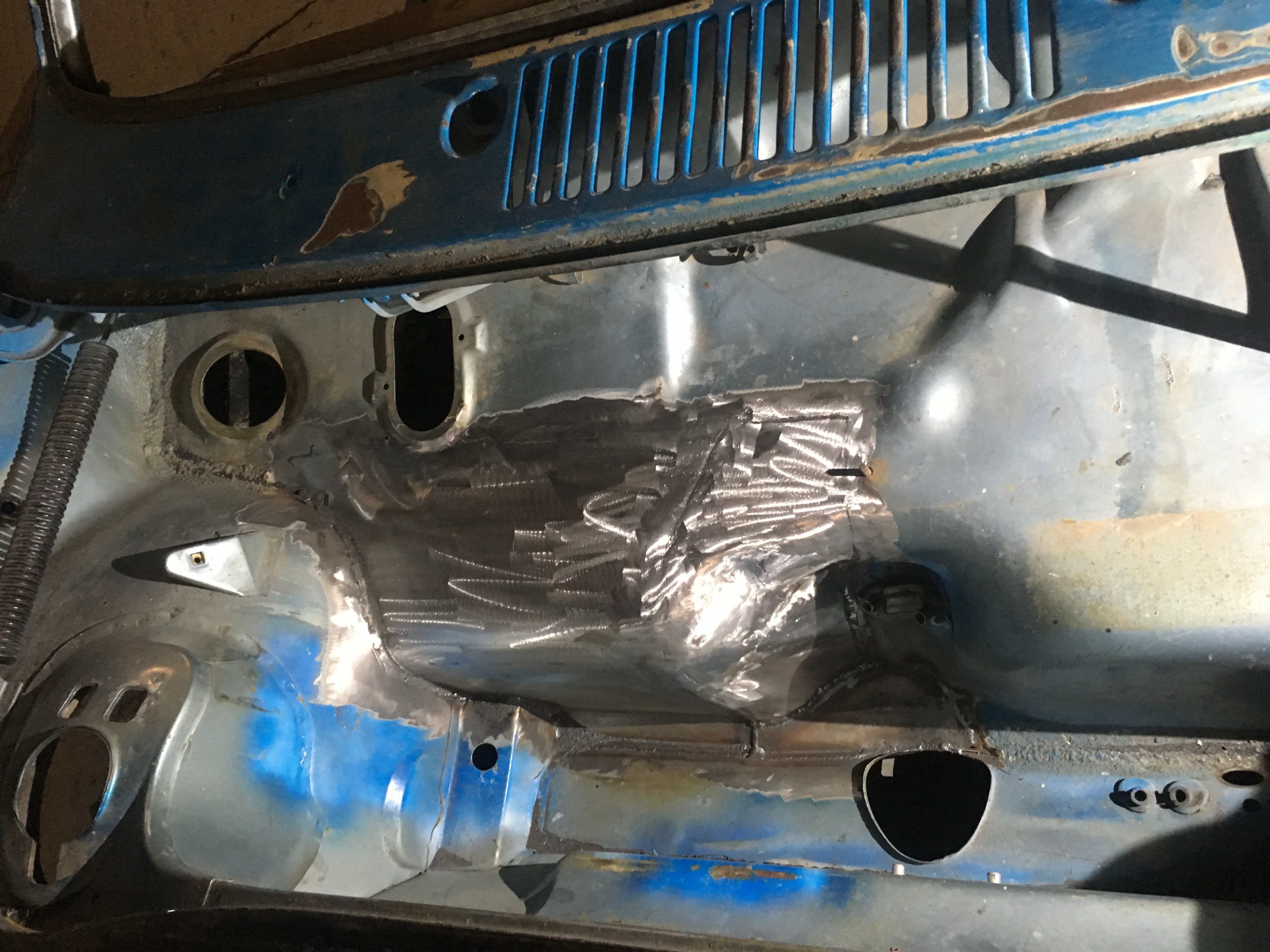

Evening everybody, to coincide with the world coming back up I have an update as well !
So between the Flu and rubbish weather I've managed to get some help to complete the RHD bulkhead.. i now have somwhere for my feet to live while on the pedals !
Its hard to show how much i've extended the footwell by, but its roughly 6 inches of new metal ! so it's off to media blasting now ... progress none the less at last !
