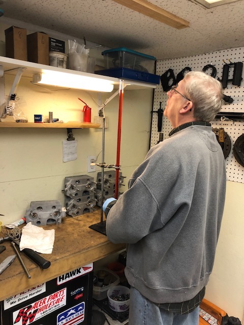

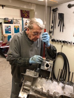

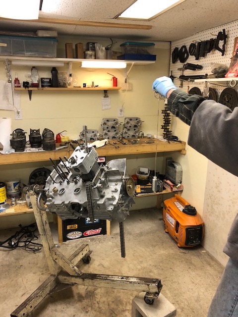

We next had to determine the swept volume and the combustion chamber volume to determine the combustion ratio.
The swept (cylindrical) volume is calculated knowing the stroke is 70.4 mm (7.04 cc) with a bore (diameter) of 90 mm, so r = 4.5 cc. Therefore = pi r squared stroke. = 3.1416 x 4.5 squared x 7.04 = 447.87 per cylinder, 2.687 total displacement. A good check to prove that the compression ratio calculation, next, will yield a reasonably accurate number.
The volume of the combustion chamber is measured empirically using a burette with a mixture of motorcycle strut oil and mineral spirits, The spark plug hole has to be at the very top for the liquid volume to be accurate
We measured (doing the procedure twice) 60.0 cc of fluid to the top of the spark plug hole, less 2.2 mL for the spark plug hole = 57.8 cc.
The compression ration, then, is v1 + v2 divided by v1 = 57.8 plus 447.87 divided by 57.8 = 8.75 combustion ratio.
Too low. JE pistons, 10.5 to 10.9, are on order and the heads are at the machine shop.
