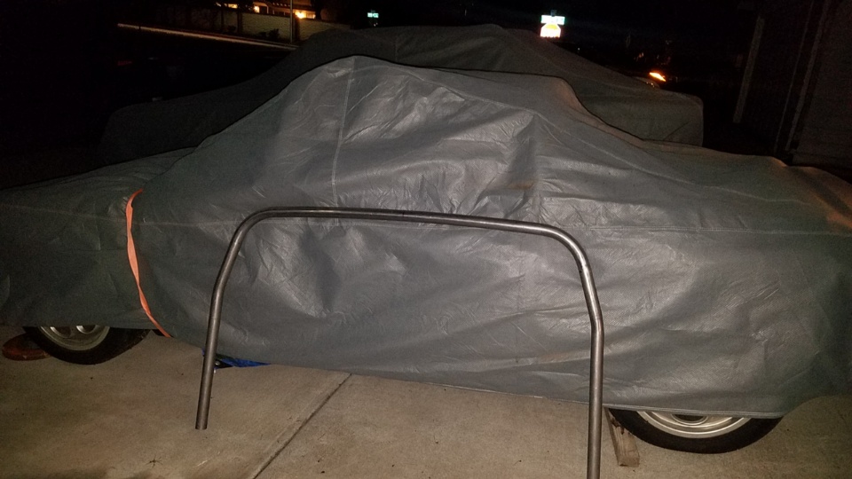

Drove up to Pet-a-llama and hung out with Chris (tygaboy) today for a few hours while he made a few tweaks to his car, he is pretty good with that tube bender!
Speaking of tube bending, this hoop just happened to find its way into the back of my truck courtesy of Chris...thanks man! I owe you.
