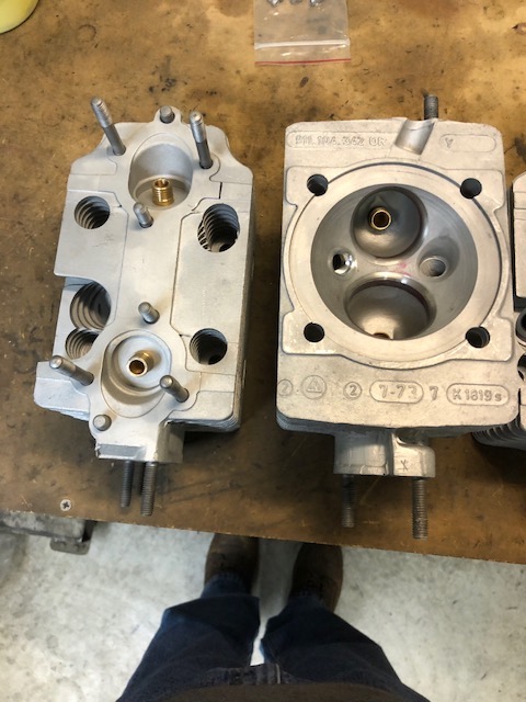

Spent the second day on the rebuild yesterday. Received the heads drilled for the second spark plug from Craig Garrett. He did a great job. Now, what is the current combustion ratio and do we need to buy higher compression ratio pistons to give effect to the twin spark? We suspect we will.
Here is what the heads look like. They were cast 7/73 for a 2.4L. They don't have a bevel where the flat edge meets the dome. Also, the 12mm spark plug is shrouded and that will adversely effect its exposure to the fuel/air mixture. Also, we measured the piston to head distance by having the piston at TDC smash a piece of solder and measuring its thickness. At .041 it is too close. All of this means another trip to the machine shop.Attached Image Attached Image
.041 is within spec what are you machining?
