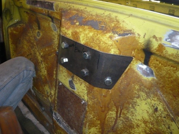

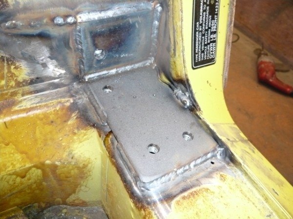

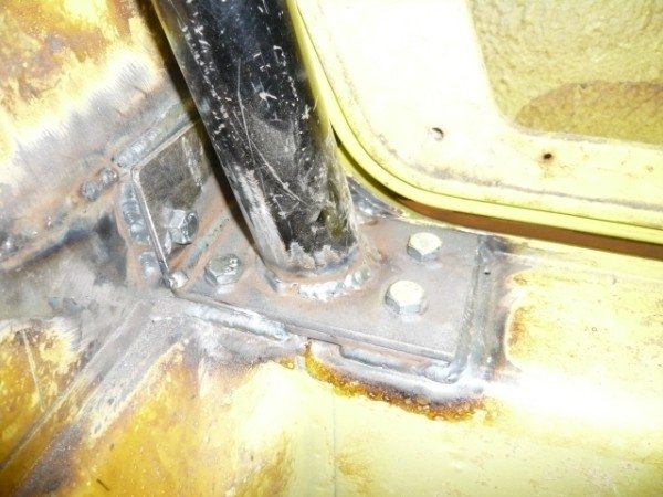

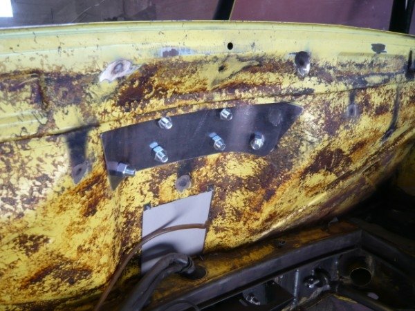

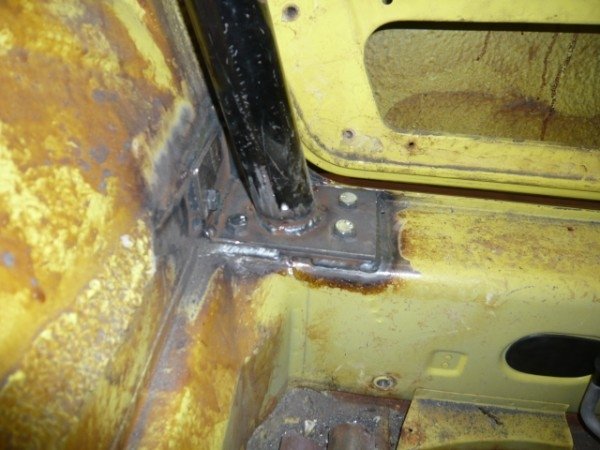

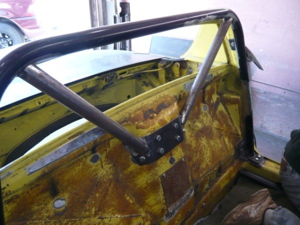

Mike - Always great to see you! I'll have to plan better next time and leverage your help.
It's certainly possible to mix and match tube sizes and wall thickness, particularly when the final product isn't going to have to pass any sort of tech inspection.
That said, unless there's some compelling reason beyond aesthetics, I'd keep everything 1.5".
I went with the .095 wall as that was spec'd for cars in the 914 weight range.
And here are the pics of the bolt in set up that I believe was done by Eric Shea.
