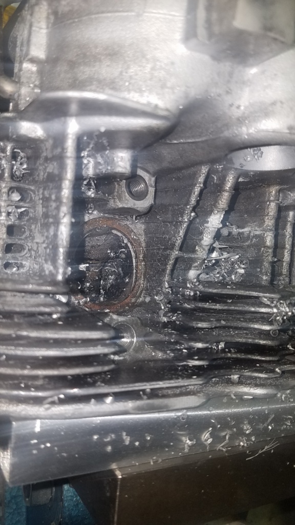

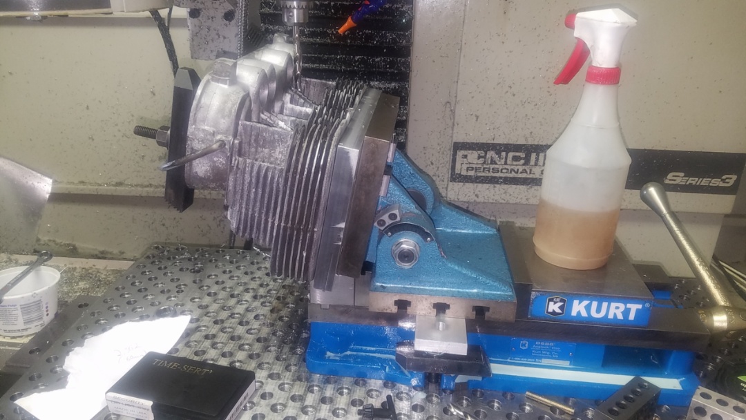

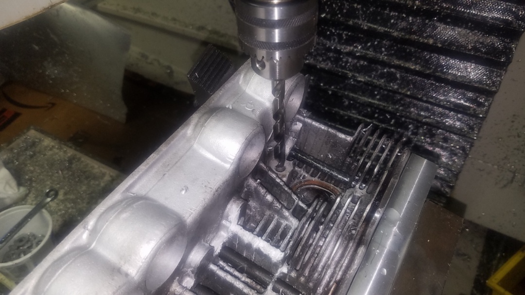

Drilled and tapped all the exhaust stud holes for Time-Serts.

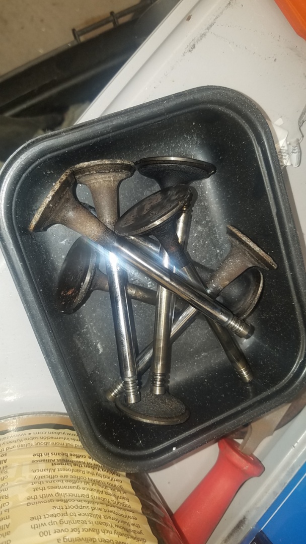

Wondering if better than stock valves should be installed right now or not.
Will be installing dual valve springs for the bigger camshaft.

Mueller   Drilled and tapped all the exhaust stud holes for ...   Jan 28 2018, 11:33 PM

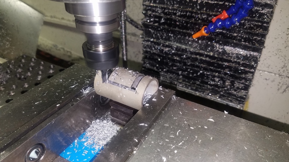

Mueller   The picture of the tube being cut is for a homemad...   Jan 28 2018, 11:44 PM
