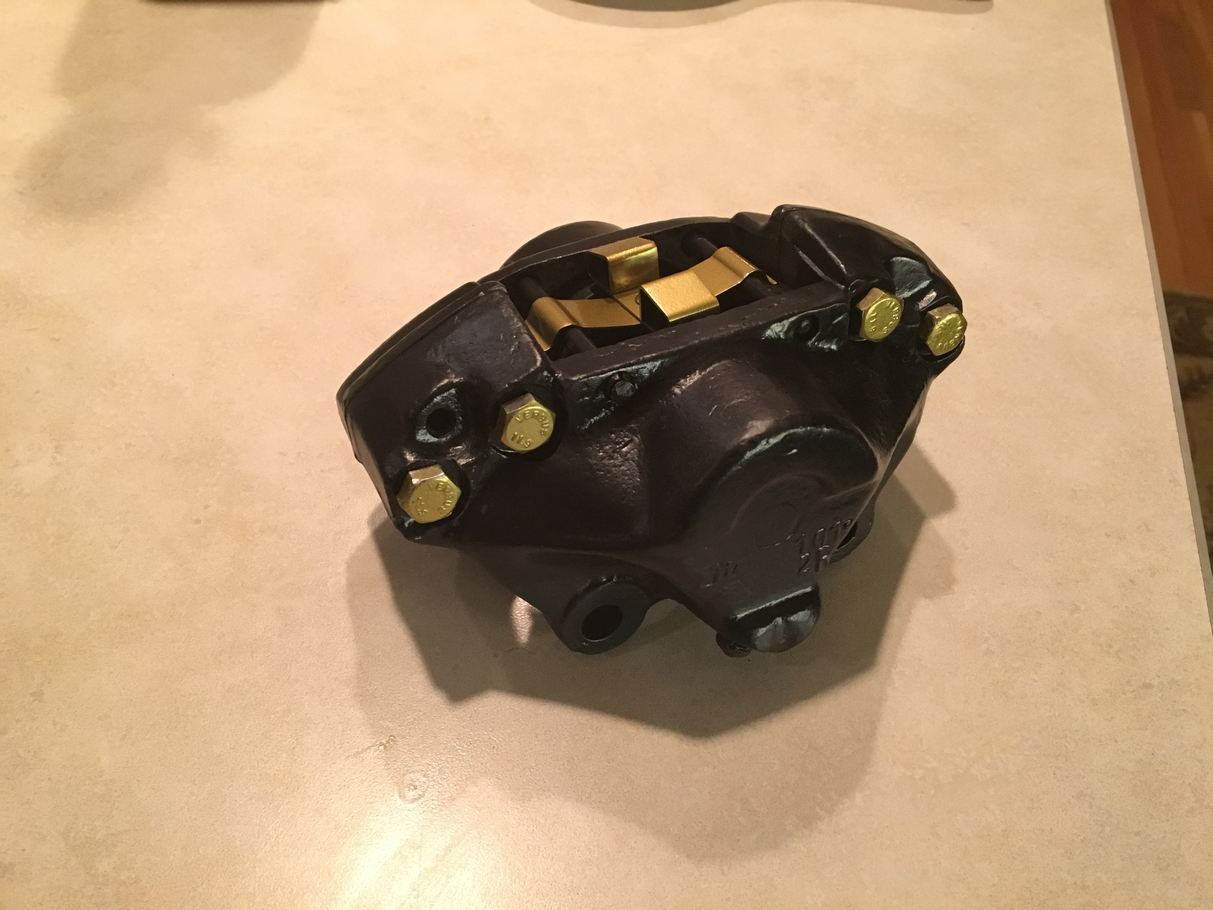

This is them finished!!! I did it myself (IMG:style_emoticons/default/smile.gif)
