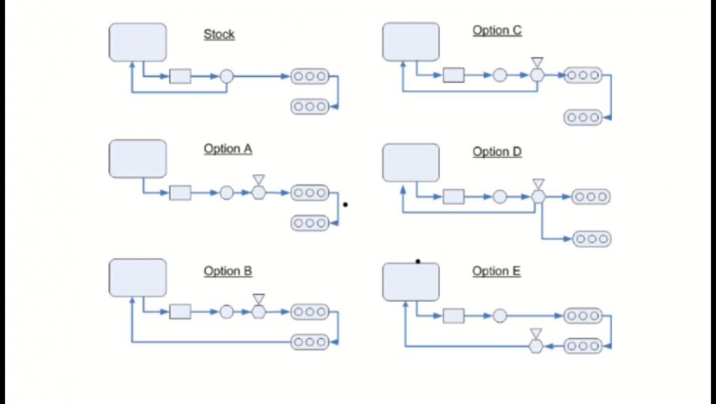

Are any of you running a retun fuel line with carbs?

On a six with Webers, I'm not sure how it works?

QUOTE(Larmo63 @ Feb 3 2018, 08:05 PM) *
Splain? (IMG:style_emoticons/default/blink.gif)

Krieger   To be clear the rectangle is the filter. Circle i...   Feb 4 2018, 10:59 PM
brant   To be clear the rectangle is the filter. Circle ...   Feb 5 2018, 12:37 PM
gothspeed   I like option E with double barb banjos on the car...   Feb 5 2018, 12:21 AM
bbrock   I like option E with double barb banjos on the ca...   Feb 5 2018, 08:27 AM
gothspeed   I like option E with double barb banjos on the c...   Feb 5 2018, 08:42 AM
Racer Chris   I like option E with double barb banjos on the c...   Feb 5 2018, 08:46 AM
bbrock   [quote name='bbrock' post='2575289' date='Feb 5 2...   Feb 5 2018, 10:22 AM
lonewolfe   I have Dellorto carbs so one has the menu intake l...   Feb 5 2018, 12:41 AM
anderssj   I've been running dual dell's with an ...   Feb 5 2018, 09:48 AM
