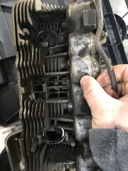

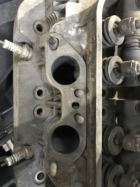

So this project may be picking back up. I found a set of, what are said to be, 1.8L heads near me for dirt cheap but they will need to be cleaned up. I'd like to make this engine a 2056 and I know this has been asked a hundred time before but, can I just drop 96mm pistons and cylinders into 1.8 heads without needed to have any work done to them, then fit them on this 1.7L case? Will the sheet metal fit too? From what I read, these are preferred over 1.7 heads for strength and performance.
Would I be better off getting Walter's 1.7 heads and doing the same, will those need to be cut for 96mm?
Finally, have a look at these heads, can you guys definitely identify them as 1.8s?
Guy states: "The heads are oval port with 40mn intake valves and a 93mm cylinder bore." I want to make sure he's not passing me bus heads or something...
