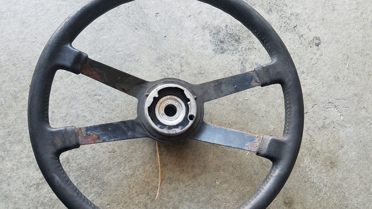

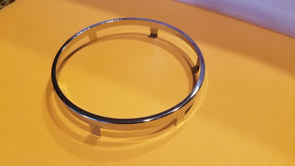

Started to gather parts to rebuild/restore my ugly steering wheel. Ring for hockey puck horn button replica that I will be making from billet alum instead of the usual plastic. Pricey little sucker, found on eBay for $42 shipped, not sure if I like it now.

Mueller   Started to gather parts to rebuild/restore my ugly...   Feb 16 2018, 12:40 PM
Mueller   Drew up my version of a hockey puck horn pad. Wait...   Feb 25 2018, 09:48 PM
