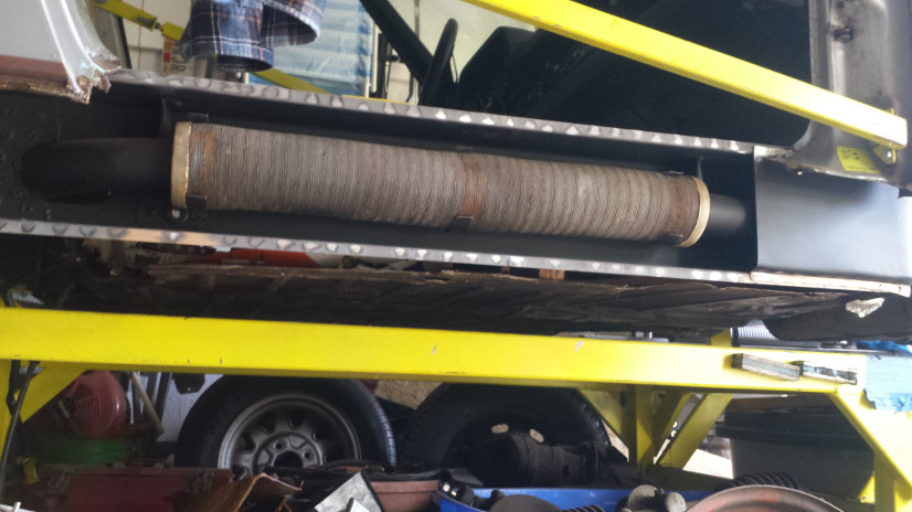

This is the heater tube in place:

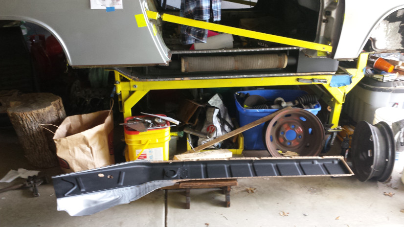

And the outer section of the long ready to go in:
