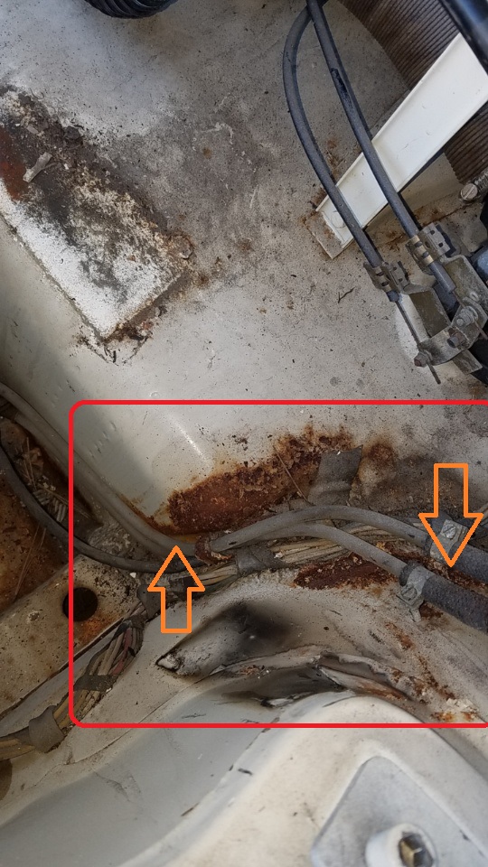

All these hoses look original to me, I'd like to replace....source for new ones?
I bought a new 914rubber master cylinder (I think I got the quick install kit but don't remember what parts came with it )

Mueller   Removed gas tank today, the rubber hoses just snap...   Feb 25 2018, 11:18 PM
Andyrew   Removed gas tank today, the rubber hoses just sna...   Feb 26 2018, 08:13 PM

Mueller   All these hoses look original to me, I'd like ...   Feb 26 2018, 05:35 PM

914forme   More than likely rusty from a couple of items. Sa...   Feb 26 2018, 08:19 PM
Mueller   More than likely rusty from a couple of items. S...   Feb 26 2018, 11:03 PM
Krieger   I have not seen the plastic brake lines fail or cr...   Feb 27 2018, 12:01 AM
