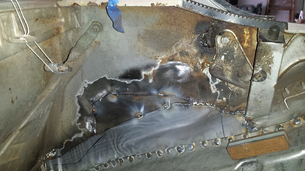

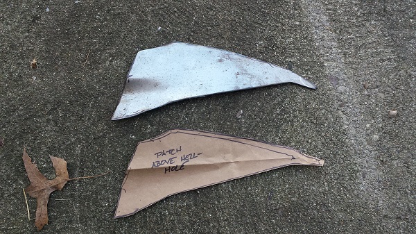

Still doing a little retro posting... The wheelhouse had a rusty section above the long. Cut it out and fabricated a patch. Lots of tippy-taps with the hammer to get the edges matched up.
Here it is tacked in:

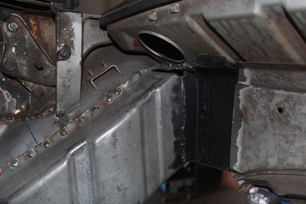

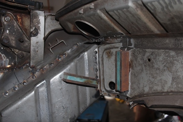

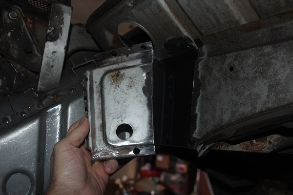

I should have detailed this part a little better, fitting the wheelhouse long at the back end. I cut out a layer of the "third" fire wall to get the long all the way up against the rear-most layer.
Made some tabs to connect the aft end of the long, then put the original piece back in place. There was a lot of head scratching here, a little bit of grinding off the welds and re-adjusting. Wasn't thinking much about taking pictures, but looking back on it, the thoughts in my head were a lot more complicated than what actually ended up happening.
