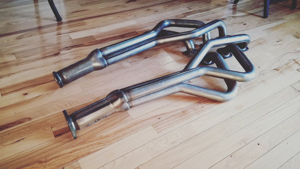

Also scored a set of MSDS headers. Went with the 1.625" O.D. headers. Wanted to be able to increase the displacement in the future if I want to, and these shouldn't be too big for the 2.2.

mb911   Been awhile since I've posted any project new...   Feb 27 2018, 09:03 AM
Optimusglen   In your experience was it 1.625 I.D. or O.D. ? W...   Feb 27 2018, 10:25 AM
mb911   In your experience was it 1.625 I.D. or O.D. ? ...   Feb 27 2018, 11:48 AM
Optimusglen   Thanks for the feedback, I have some messages out ...   Feb 27 2018, 11:54 AM
mb911   Thanks for the feedback, I have some messages out...   Feb 27 2018, 12:11 PM
Optimusglen   Looks like I'll be holding onto these until th...   Feb 27 2018, 12:37 PM
