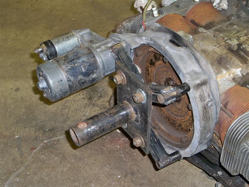

toolguy   The 3 arm yoke is fine, , the 2 arm ones [typical...   Feb 28 2013, 02:52 PM
Valy   This is what I've got - an adapter for the reg...   Feb 28 2013, 03:14 PM

doug_b_928   Thanks for the pics, Ian. Anybody have comments...   Mar 3 2018, 02:27 PM
Valy   I would prefer the 3 ARM one. It's strong enou...   Mar 3 2018, 03:09 PM
cuddyk   I have the 4 arm one, which you can see in the pic...   Mar 3 2018, 04:07 PM
doug_b_928   Thanks very much for the feedback guys...3 arm it ...   Mar 3 2018, 05:16 PM
bbrock   I have the 3-arm on an HF 1000 lb. stand. Seems p...   Mar 3 2018, 06:02 PM
