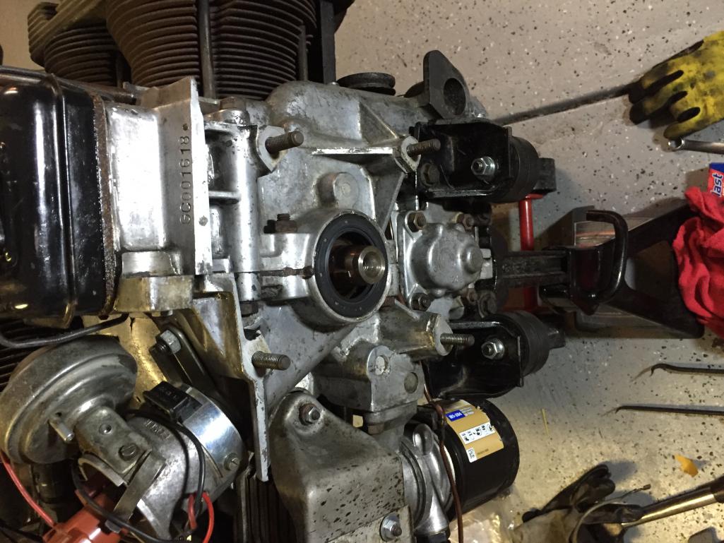

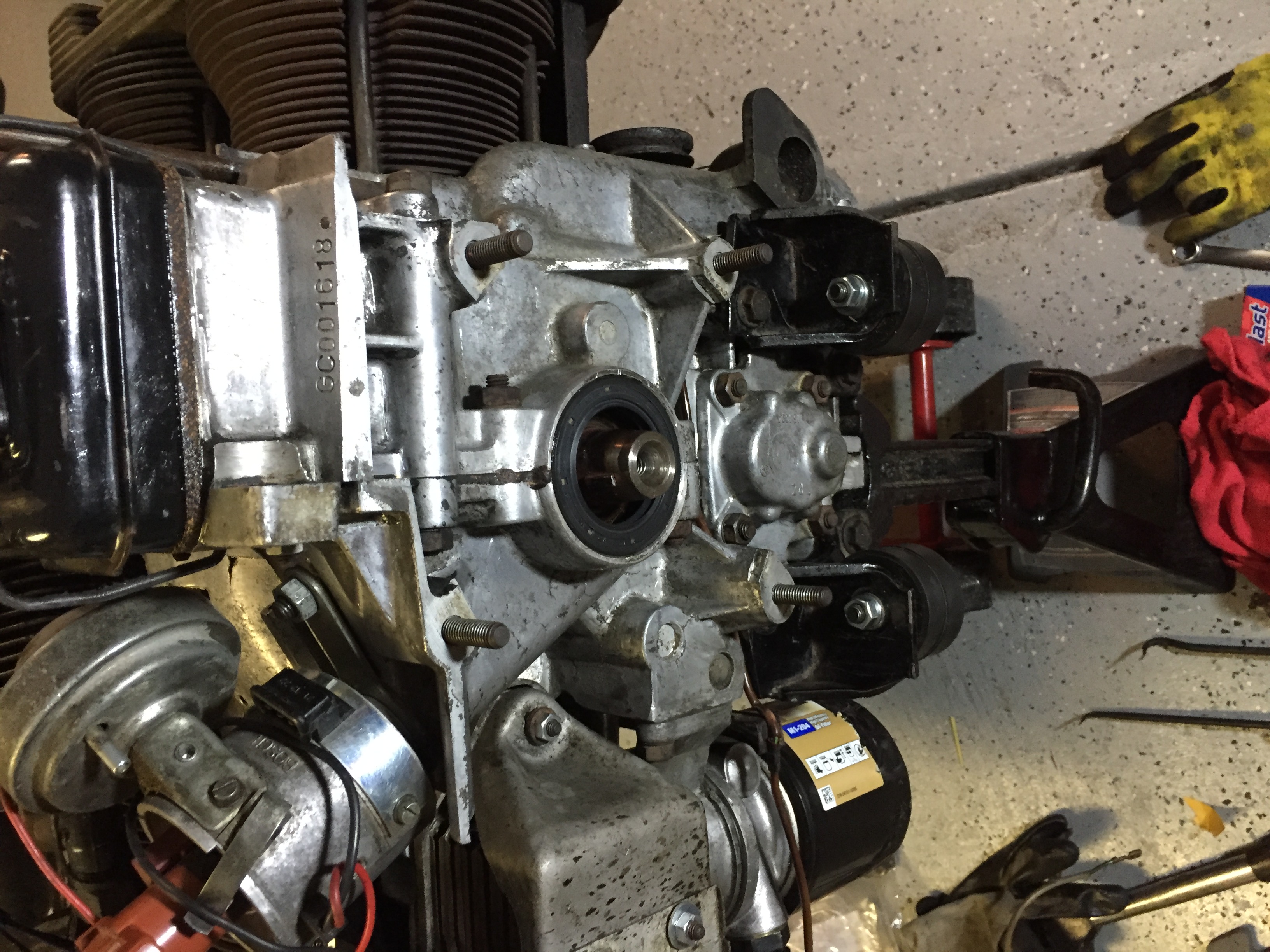

Philip W.   been working on getting all my bits together for t...   Mar 5 2018, 07:01 AM
Philip W.   dirty motor   Mar 5 2018, 07:28 AM
Philip W.   so dirty, lots of undercoating spray and 40 years ...   Mar 5 2018, 07:37 AM
Philip W.   so much nicer !   Mar 5 2018, 07:40 AM

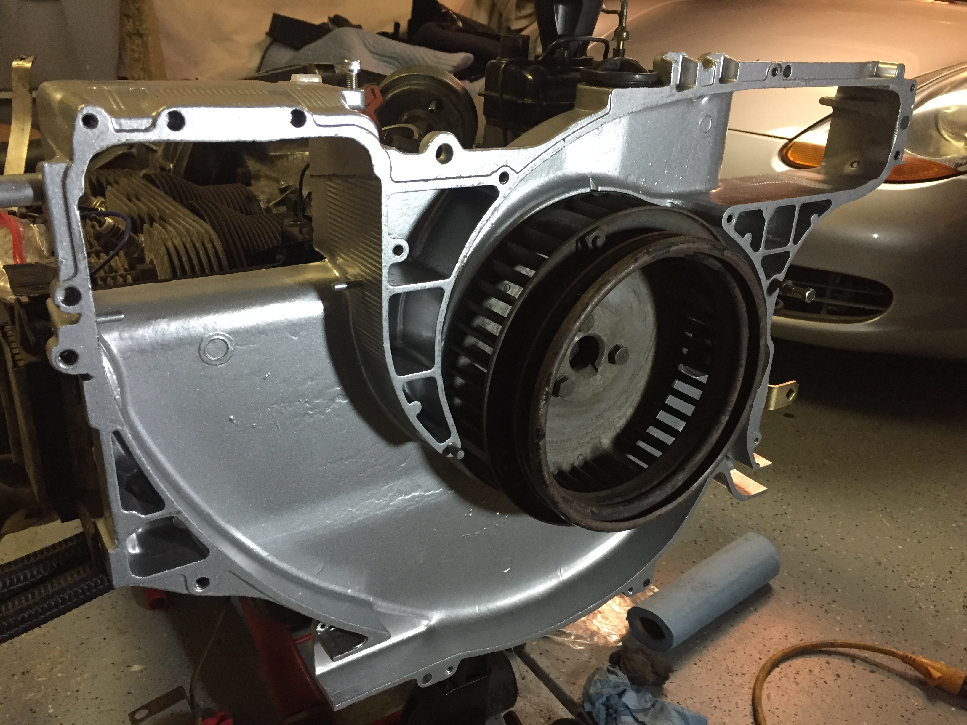

Philip W.   shroud back on but the Alternator cover i got is ...   Mar 5 2018, 07:43 AM
Philip W.   assembling the new clean runners with zinc plates ...   Mar 5 2018, 07:47 AM
Philip W.   new motor mounts and brackets   Mar 5 2018, 07:48 AM
Philip W.   i ulled the oil cooler to put in new seals ans als...   Mar 5 2018, 07:54 AM
