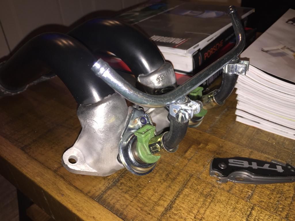

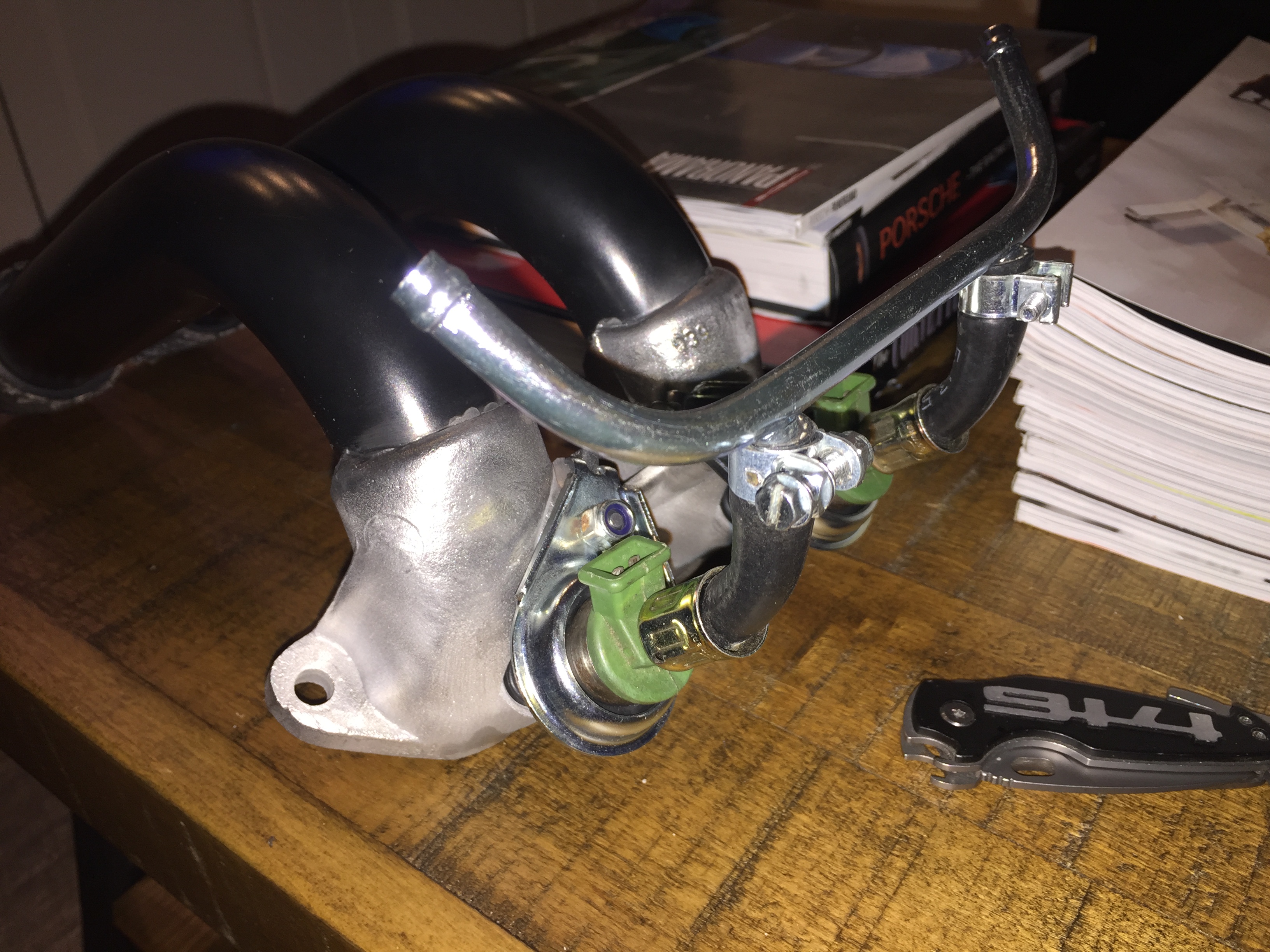

assembling the new clean runners with zinc plates fuel rails

Philip W.   assembling the new clean runners with zinc plates ...   Mar 5 2018, 07:47 AM
