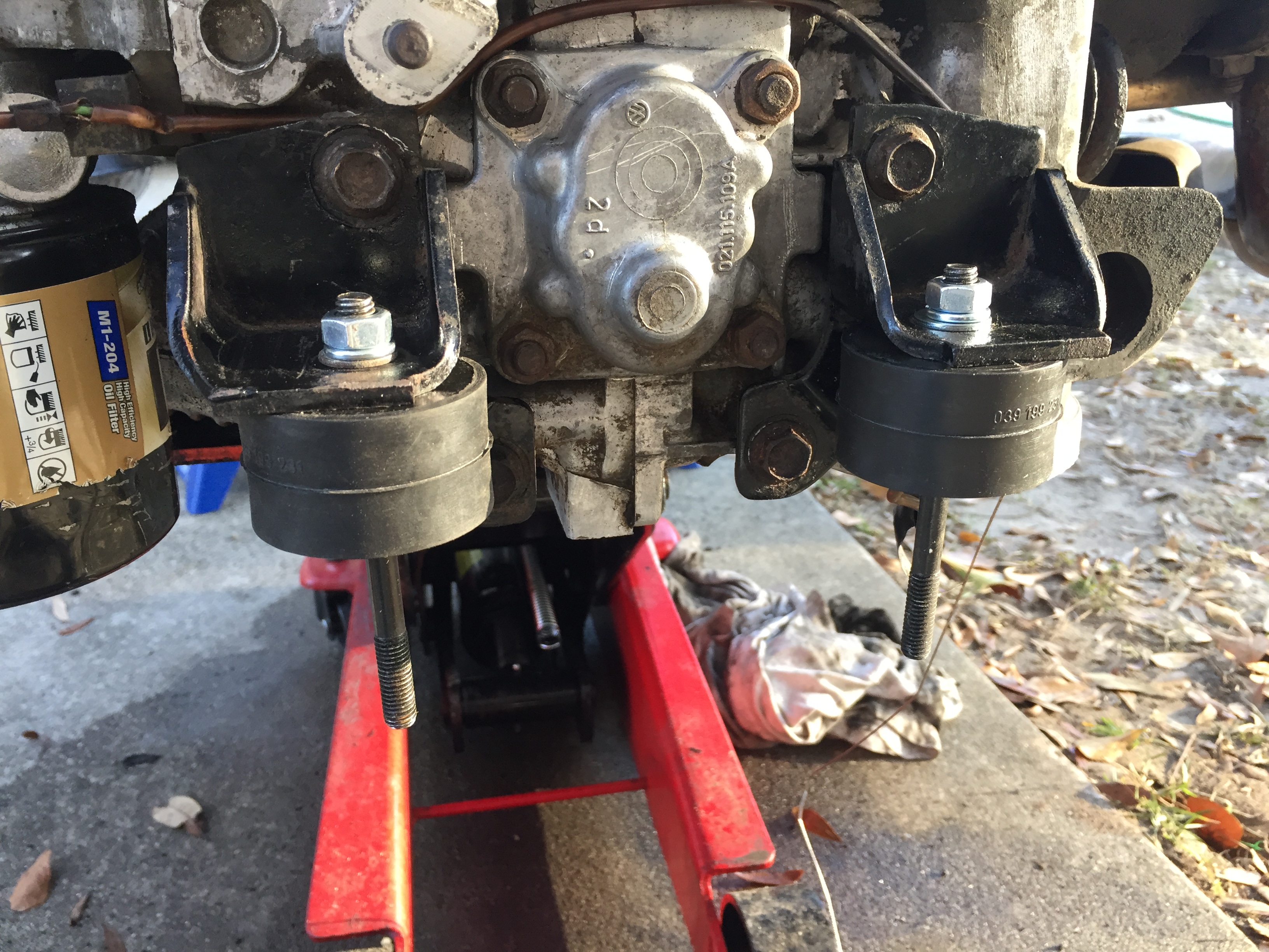

Philip W.   new motor mounts and brackets   Mar 5 2018, 07:48 AM
