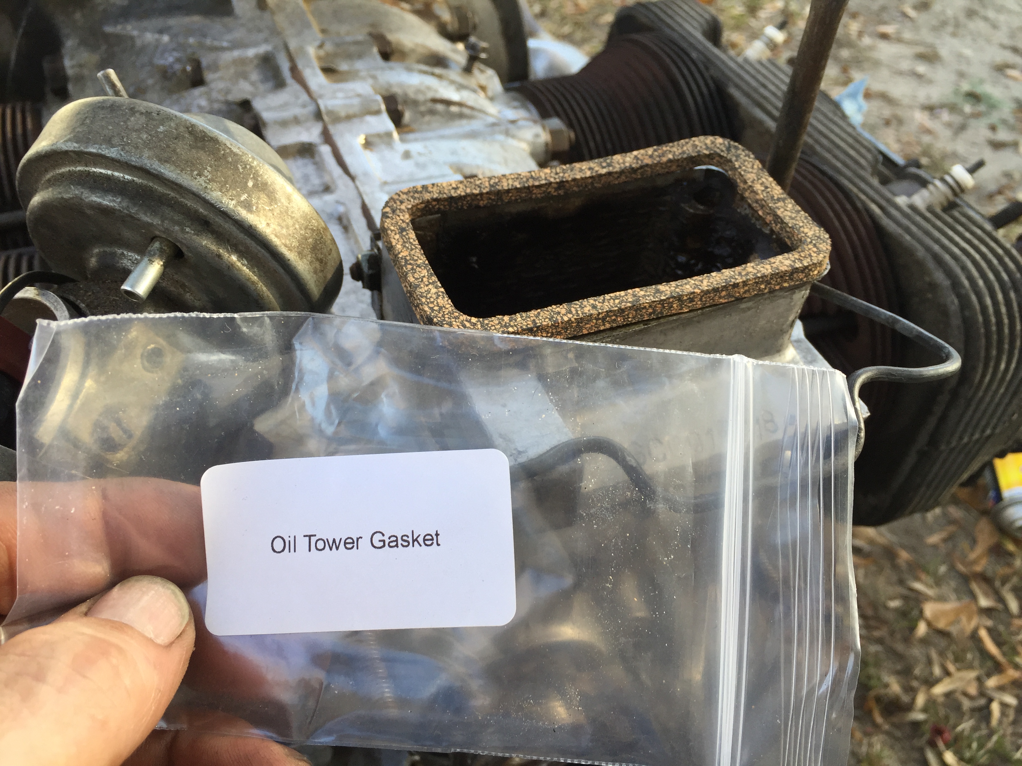

i ulled the oil cooler to put in new seals ans also this seal for between the tin and the oil cooler
i am trying to do everyting i can while i am there- i dont want to have to pull this until i decide to do a bigger motor
