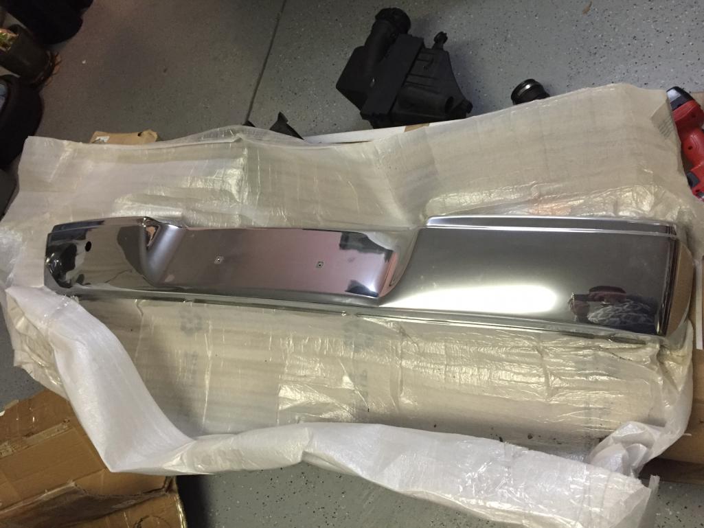

bumpers!

Philip W.   bumpers!   Mar 5 2018, 08:00 AM
Philip W.   feont bumper with top- i have 2 now ans will have ...   Mar 5 2018, 08:09 AM
Philip W.   this one has the holes for bunper guards and has a...   Mar 5 2018, 08:12 AM
