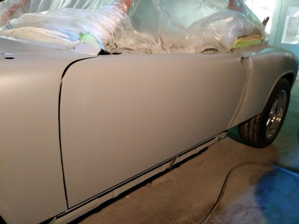

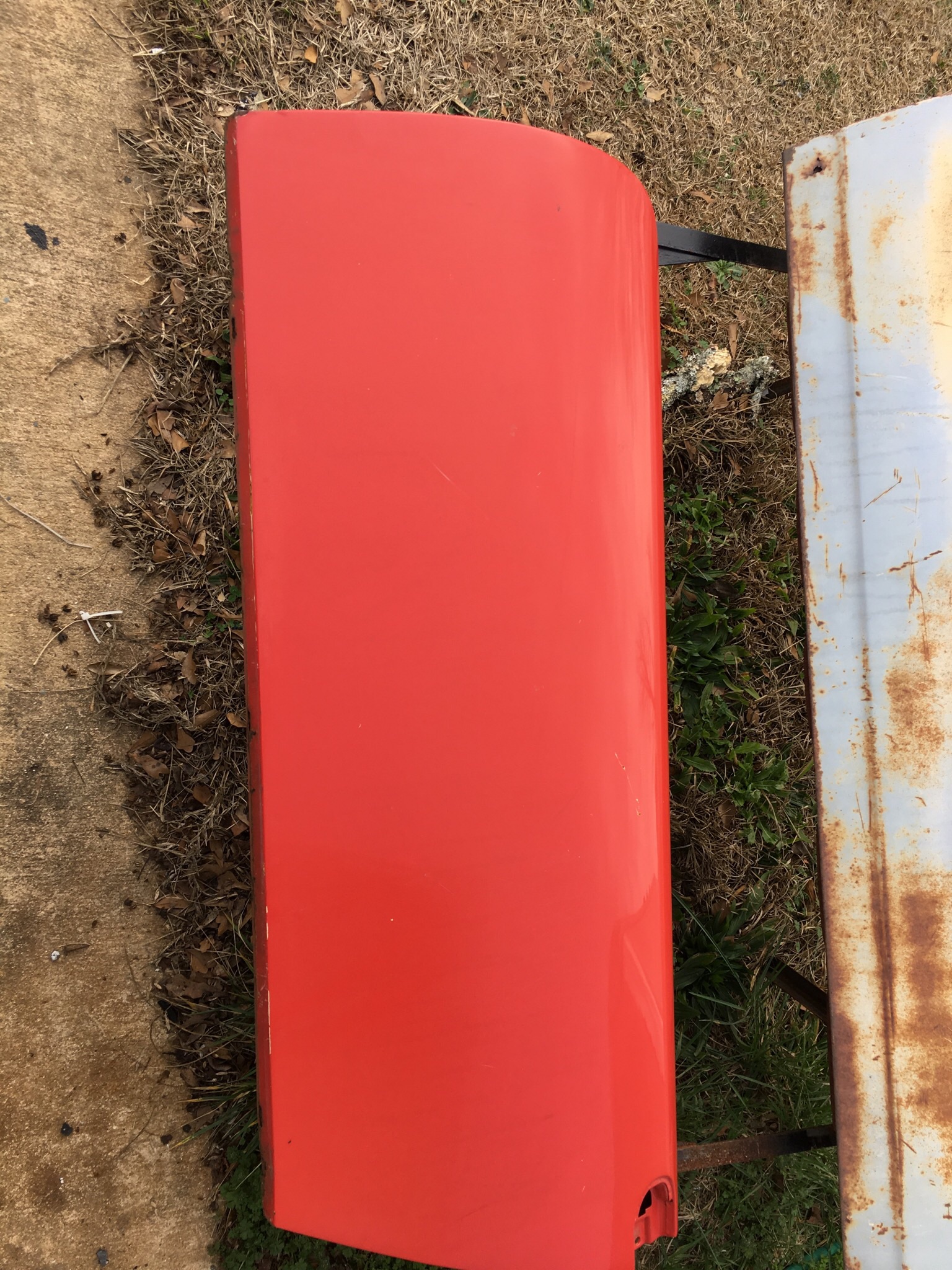

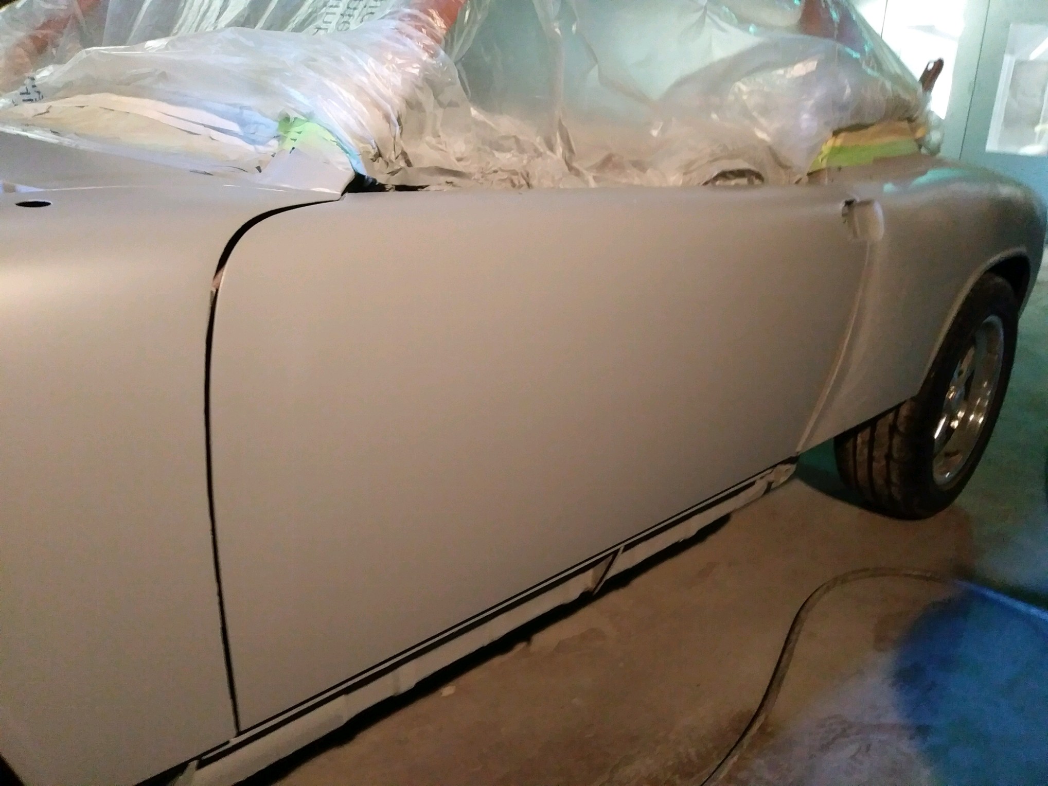

so new door, was way better than the old ine with rust in channel, inside and thru- some po used a bunch of bondo to cover up - now new door primed and in the car- rear bumper and a front bumper with super nice top sourced last weekend locally,
trying to decide about using early bumper no guards etc or this later one that will need some work and has thr holes for thr tits, either paint it or rechrome it we will see- been trying to get some prices on chrome work and repair

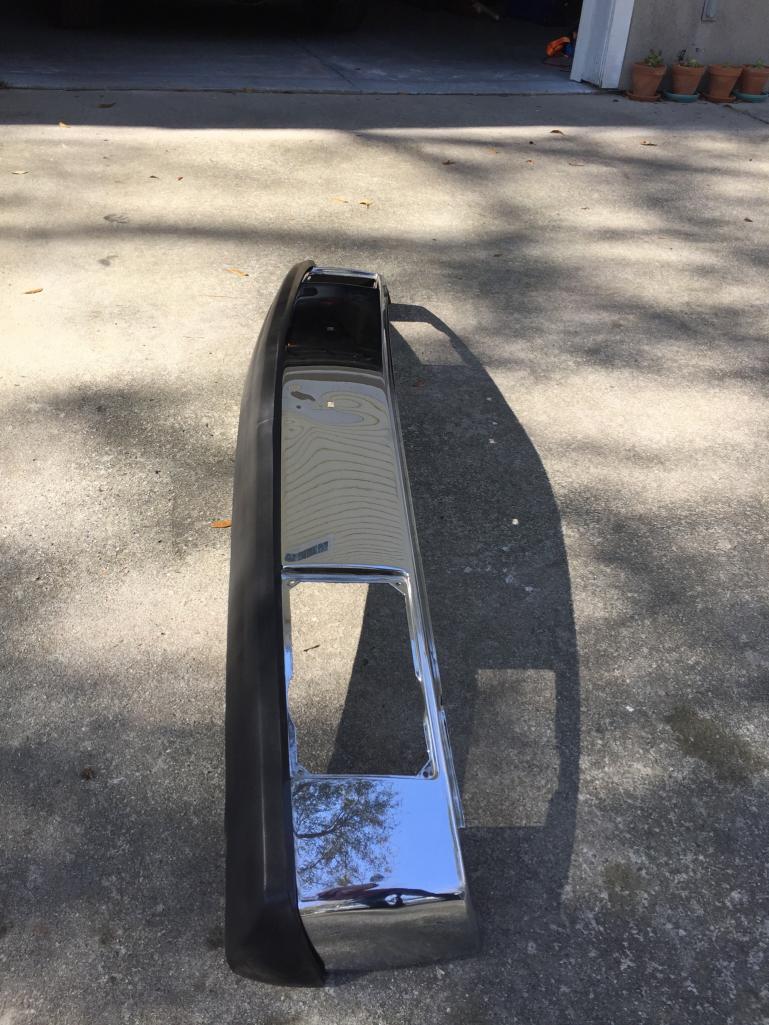

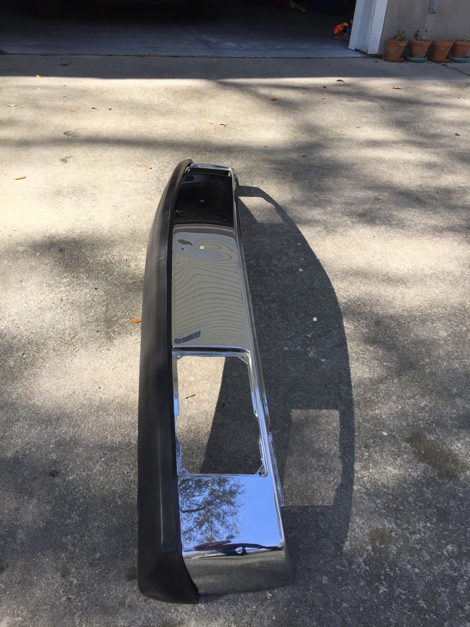

Philip W.   bumpers!   Mar 5 2018, 08:00 AM
Philip W.   feont bumper with top- i have 2 now ans will have ...   Mar 5 2018, 08:09 AM
Philip W.   this one has the holes for bunper guards and has a...   Mar 5 2018, 08:12 AM

Philip W.   so new door, was way better than the old ine with ...   Mar 7 2018, 01:05 PM
