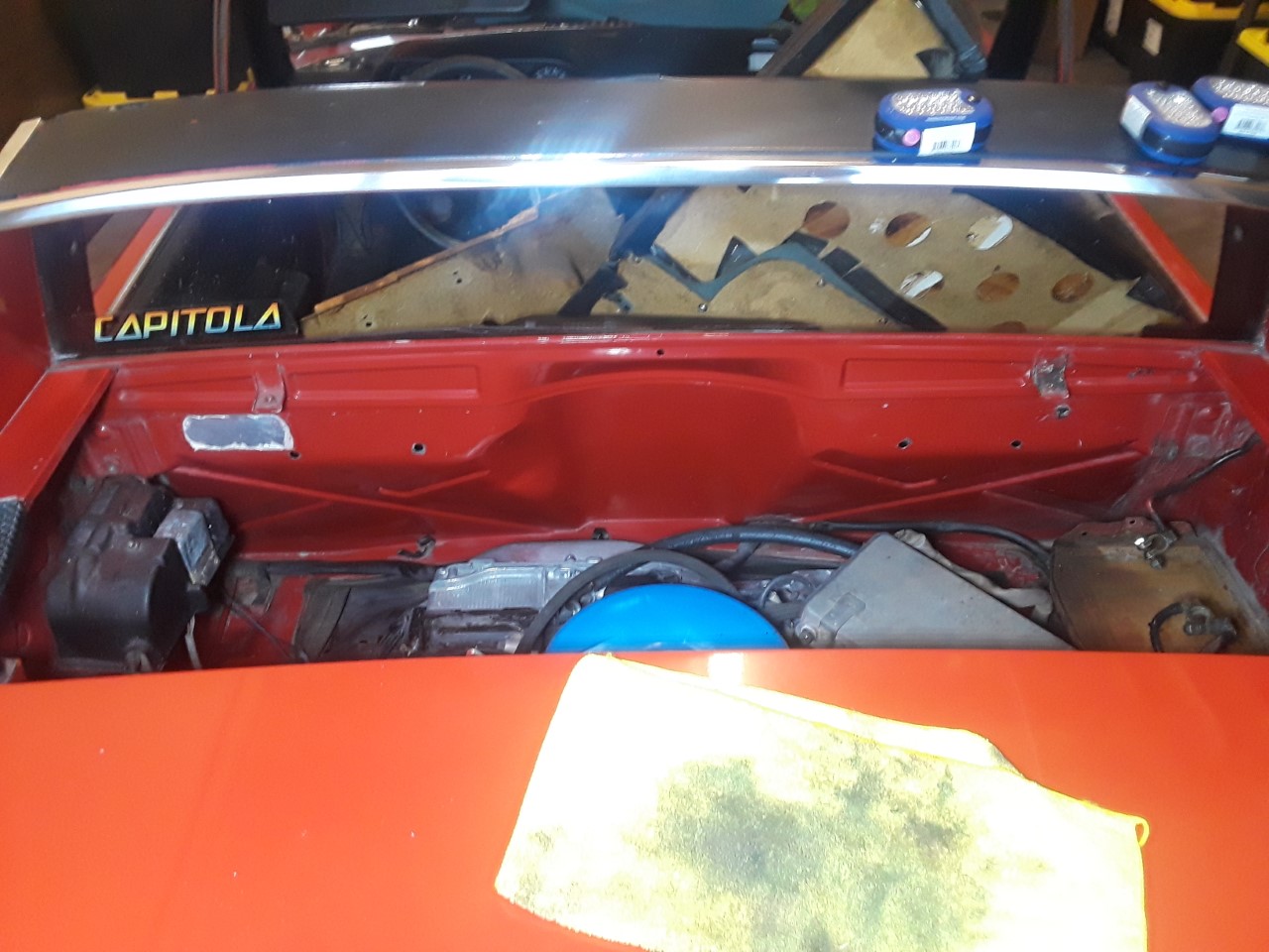

My trunk opens (& always has) into the small grill sections either side of the decklid.
rubber mark has some angled rubbers for a bracket in this area but i cannot find in google images any pictures with this bracket fitted.
Can someone show me this on their car?

here's a picture of mine. It was properly adjusted to close and had been repaired on the passenger side at one time. the key is the brackets have a solid mount and no flex. as well as being aligned. If you have rust at the mount point it will need to be repaired prior to reinstalling the bracket as it may have enough flex to cause the problem you are mentioning. here's mine.

theer   I think the angled rubber piece you mention is the...   Mar 6 2018, 02:35 PM
Mikey914   I'll post up some pictures here for clarificat...   Mar 6 2018, 03:45 PM
UROpartsman   Are you talking about the little rubber bumpers in...   Mar 6 2018, 04:08 PM
Olympic 914   That L-shaped piece only comes into play if you op...   Mar 6 2018, 05:30 PM

Mikey914   The hinges on the deck lid can be bend slightly to...   Mar 8 2018, 10:06 AM
boxstr   Okay, to get away from the URO pissing match. I lo...   Mar 8 2018, 03:34 PM
jcd914   It looks to me like the hinge pivots may have been...   Mar 8 2018, 03:38 PM
Mikey914   I'm redoing my deck lid on the 72 this next we...   Mar 8 2018, 03:47 PM
